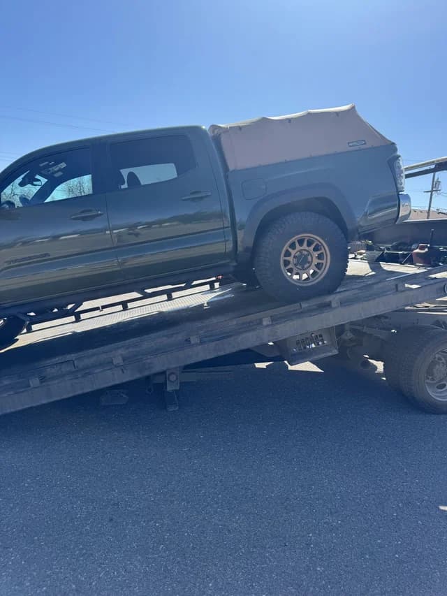

Started up my 2022 Tacoma OR with 30,000 miles and immediately got a check engine light and trac off light. Thought I could limp it home (just a mile, slightly uphill), but as soon as I hit the gas, I noticed it had almost no power. Couldn’t even make it up a small hill, so I had to turn around.
Going back downhill, I tried giving it more gas, which triggered a bunch of alerts, flashing lights, and then the truck just shut off. Coasted into a parking lot and had it towed to the dealer. Hoping they cover it under warranty.
Pulled the codes while waiting for the tow truck. Seems like the truck went into some kind of “safe mode” to prevent damage.
