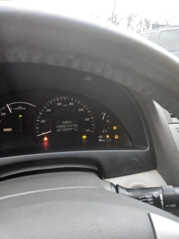

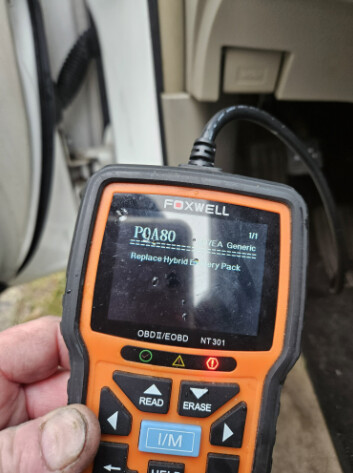

I recently bought an 07 Camry Hybrid for my son. It had a dead 12V battery, so I replaced it with a new OEM Panasonic battery from the dealer. Now, the check engine light is on, and the message center says ‘check hybrid system.’ My scanner shows a code indicating the hybrid battery cell needs replacing. Is it normal for this to happen after replacing the 12V battery? Could it just be the system needing time to recalibrate, or does the hybrid battery actually need replacing? Any advice on testing or next steps would be appreciated!

Yeah, I did the installation myself. Everything seemed fine during install. Hoping it’s just a reset issue.

Got it. If the hybrid battery is the original, it’s likely time for a replacement. They usually last about 10-15 years.
Sounds like the hybrid battery is failing. It’s separate from the 12V battery and unfortunately costs a lot to replace. Hopefully, the rest of the car is in great shape!

Yeah, I got it for $2,000 from a friend. It’s got new brakes, tires, and no rust, so I don’t mind putting money into it. Any thoughts on how reliable refurbished battery packs are?

Refurbished packs can be hit or miss. If you’re keeping the car for a while, I’d go for a new Toyota battery for peace of mind.
If you want to test the battery condition, the ‘Dr. Prius’ app is great. It can check individual battery cells and overall health.

Thanks for the tip! I’ll download the app and see what it shows.
