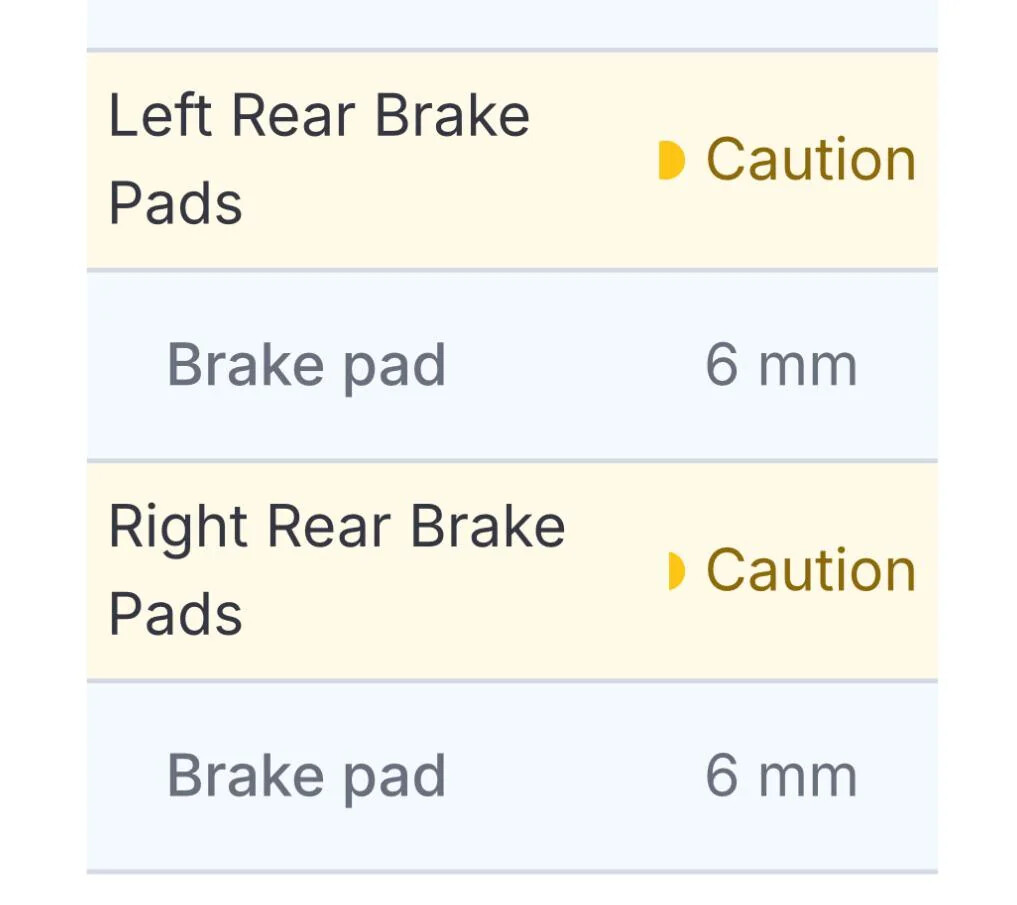

I went in for my 15k Toyota service and my rear brakes are already at 6mm. I just want to ask if this is normal for a 2024 Limited.

That must be the reason my pads are already at 6mm. If I didn’t use the auto adjusting cruise so much, they’d probably be fine.
They flagged brake pads at 6mm?? You should stop going there. Your pads are fine as they are.

Well, I have Toyota Care, so I can’t stop going to the dealership. :confused:

The pads aren’t an inch thick when new; more like half an inch or around 13 mm.

I don’t know why, but at work, I often see Tundras with significantly lower rear pads than fronts. Yes, even as early as 15k miles.
No, but 6 mm is nearly half remaining. Normal driving could yield another 40k miles. My guess is that the tech doesn’t recognize 6 mm compared to 10 or 11 mm.
