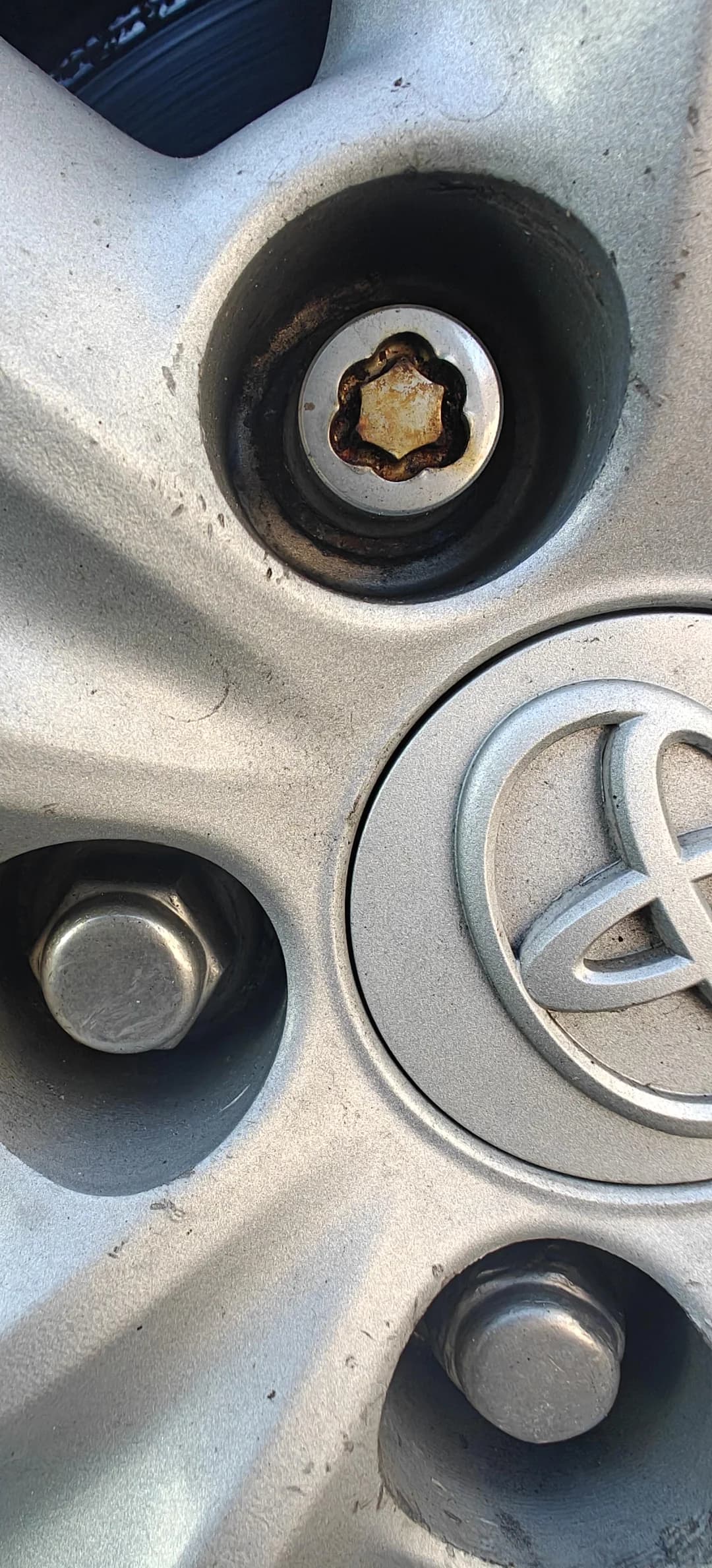

Lost my wheel lock key… how do I get a replacement
I need help finding a replacement wheel lock key for my 2014 car. Any advice would be really helpful.

That set won’t work. McGard makes your wheel lock, and each manufacturer has different locks. For example, Honda has 20 different ones.

Don’t bother. It’s a Toyota wheel lock. If you don’t have the key, just go to a Toyota dealer and ask them to replace the locks with regular lug nuts.
If you don’t have the code, you’ll probably need to drill out the lock and get a new set, possibly with new studs.

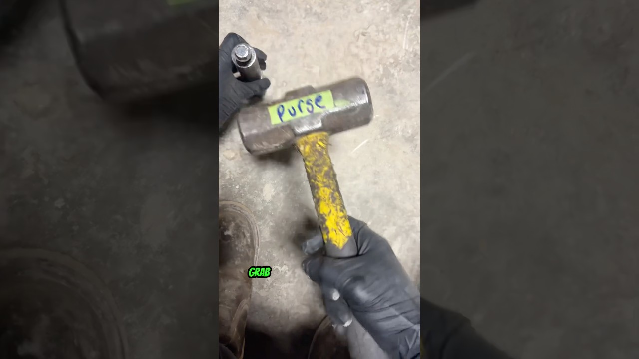

Hammer a 12-point socket onto the lock, then remove it like a normal lug nut. Replace it with a regular one.

This is the way! I’ve done this countless times when I worked at Sears and Pep Boys. Just hammer a socket on and zip it off. Replace it with a regular lug nut. Wheel locks are pointless—if someone wants to steal your rims, they’ll just hammer a socket on and take them anyway.

That’s a McGard wheel lock. Any Toyota dealer will have a master set to remove it. They can also get the part number and order you a new key. It should cost less than $20.

Not true. I’ve worked at a Toyota dealer for 30 years. We have master sets of McGard locks. Each master key has a number that can be used to order a new key. They just need to match the pattern. This one is easy to spot—it’s got a three-sided shape I call the Triangle.
When my dealer lost my key, I ordered a new set from mcgard.com. I sent them photos, and they matched it. This was 6 years ago, but they’re still around.

Hammer a 19mm 12-point socket onto it and torque it off. Easy!
This is how you do it.
