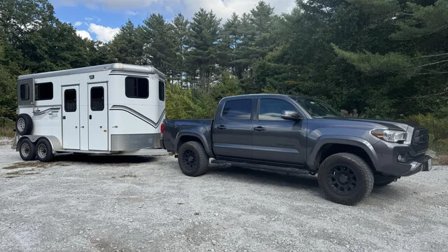

I tow a two-horse trailer pretty often, about 3,000 lbs total. The truck handles fine—no issues with sway or braking—but the rear sags a bit. I’d like to get a little lift and take some of the stress off the suspension without making the ride too stiff when I’m not towing.
I’ve been looking at options, but it’s confusing since most are either for heavy-duty use or meant to be adjusted all the time. Since this is my daily, I don’t want to mess with manually inflating and deflating airbags. Do I have to replace the whole suspension, or is there a simpler fix? Truck is a 2016 Sport 4x4 with a tow package.
