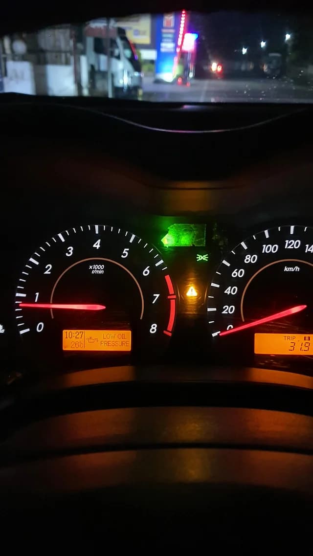

I just bought a 2010 Toyota Corolla 1ZZ 5-speed with less than 90,000 miles. It’s my first car and I paid for it with my own savings. Got an oil change done two days ago. Last night while driving home I gave it some good revs on an empty road for the first time, and after a few minutes the low oil pressure light came on and the engine got noisy. I pulled over, turned off the engine and waited 10 minutes. After starting it again, everything seemed fine. The light went away and the noise stopped. But now I’m really worried. What could’ve caused this?

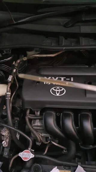

Did check the oil level!

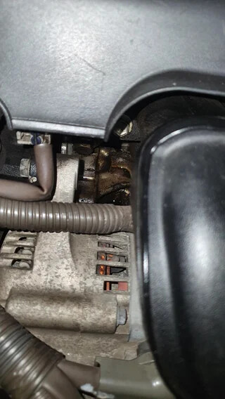

The valve cover is letting oil seep out.
@Mica
That picture helps…

Sorry if it’s a dumb question, but can a leaking valve cover alone make the engine knock or lose oil pressure? The dipstick shows oil level is okay.
@Mica
When was the last time you changed the oil? Also, was that reading you took from the dipstick the first one, or after wiping and checking again? Some people don’t know the first dipstick pull isn’t accurate unless the car has sat for a long time. You’re supposed to wipe and re-check it.
@Devlin
I got the oil changed just two days ago. That picture was after I wiped and checked again.
