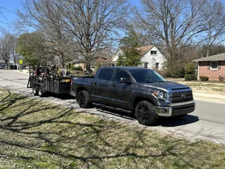

Been towing with my 2020 1794 since day one. Pull a 16ft trailer 5–6 days a week for my landscaping business. At 196K miles now—added a cooler at 10K miles ago just as a precaution, but never had issues before or after.

That’s great to hear! Ready for the season to start!
