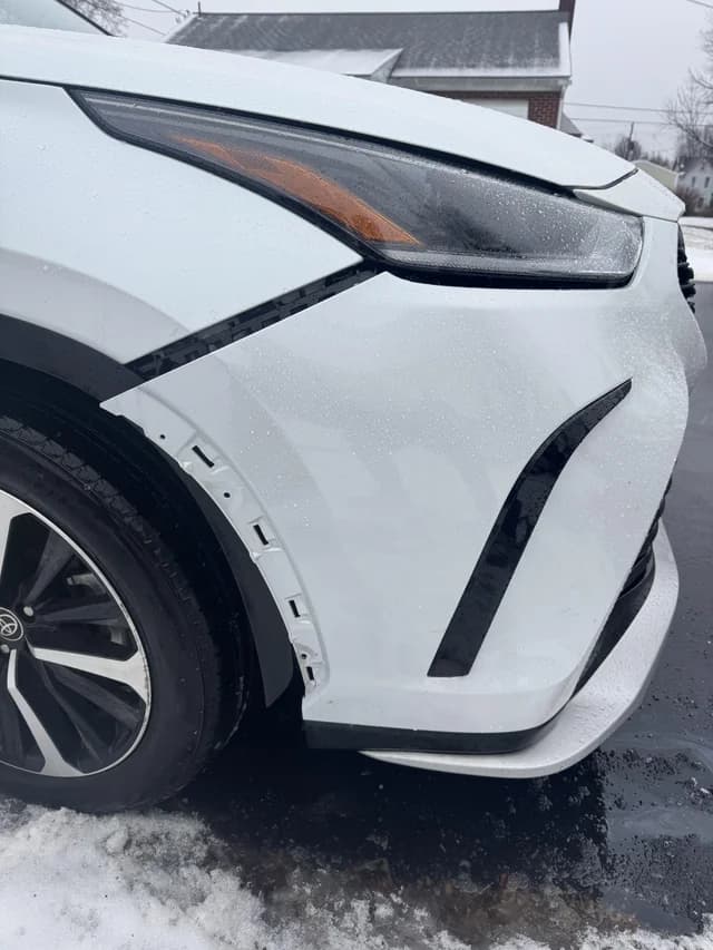

How is Toyota and all of these auto manufacturers producing this crap? These are basically Chinese plastic on wheels with a bunch of fancy tech. Turned the wheel a little too quick and caught my bumper… pulled away. Snapped it back together with all plastic pieces… so flimsy. Just completely unimpressed with a $50k vehicle.

Not sure how the wheel under normal load could catch your bumper or the wheel well plastic liner. Remove a 10mm bolt at the bottom of the front wheel arch, and a few plastic push pins, pull the arch trim back, and you can snap back the bumper cover into place. There’s a second 10mm bolt 1/4 up the arch too if you need to remove that. Also, if the black plastic mounting piece behind the bumper (arch area) is broken, buy a new one off eBay. If the wheel arch trim has a few broken tabs just put double-sided 3M automotive tape; it will hold. You can buy a new arch trim for about $50 too. Most vehicle bumpers are snapped together this way. Easily a DIY fix. Coincidentally, the iPhone, laptops, flatscreen TVs are mostly Chinese made too, and so’s your socks and underwear, LOL.

Sorry, not clear. I was backing up out of a driveway and turned the wheel too soon and the bumper scraped over the raised curb on the side of the road. 100% my fault.
