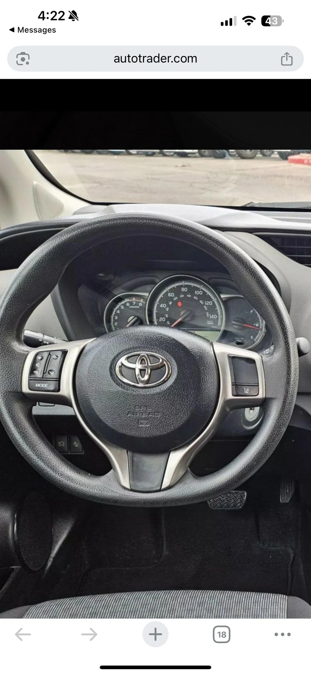

Hi! I just bought a 2017 Yaris for my daughter, and I’m trying to upgrade the stereo so she can have Apple CarPlay—I want her focused on driving. My question is: can I add the extra buttons for answering and hanging up calls to her steering wheel without needing to change the clock spring?

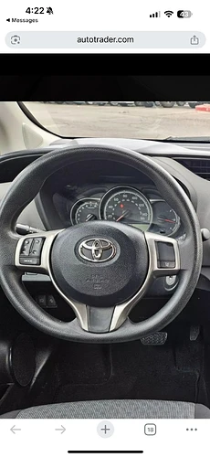

Also, her current steering wheel has lane assist, but the new button set I’m looking at replaces that with cruise control. Would that mess up any of the existing functions? I attached photos of her current steering wheel and the new part I want to add. The new button set has 10 pins.
Or does anyone have a better suggestion for upgrading to an Apple CarPlay unit and adding steering wheel controls?
The buttons to answer and hang up calls are not really worth it since the main screen is only a few inches away from those buttons anyway To answer your question the part that connects the steering wheel to the car’s electrical system is the same no matter which buttons are on the steering wheel only the basic model with no buttons has a different part

This many non-original parts will give you a system that uses different levels of electrical resistance just plug the buttons into the main screen and set it up in the settings menu

This car does not have the ability to automatically keep a certain speed can we set it up through the radio to do something else Or will it still automatically be the button that helps you stay in your lane
@Beryl
The automatic speed control is on a separate lever Just install and enjoy For the lane assist you will need a set of devices that sense things

If you get the buttons you linked above you’ll lose the lane keeping button which may cause you some problems at some point I really don’t see the point with such a small car
The best thing you can do is open the instructions for installing that main screen and see what the wires look like Hopefully it has the steering wheel inputs in the connection which are usually labeled sw1 sw2 and ground
