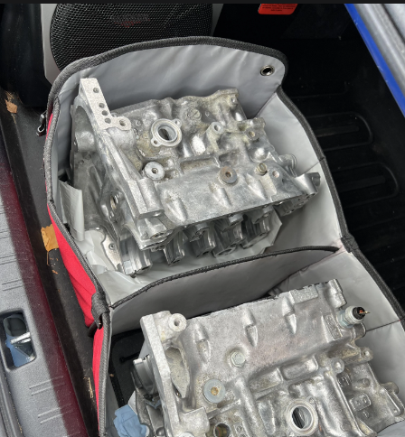

How are you planning to clean up the block decks before putting the heads back on?
Same as always—razor blade, patience, and a sore back!

Subaru actually allows the white bristle Roloc discs for that. I still go easy with them, but they do the job well.
Paper towel like a normal person, obviously. lol

Honestly, it’s not too bad if you unbolt the three motor mounts. Lifting the engine just a little gives you way more space to work with.

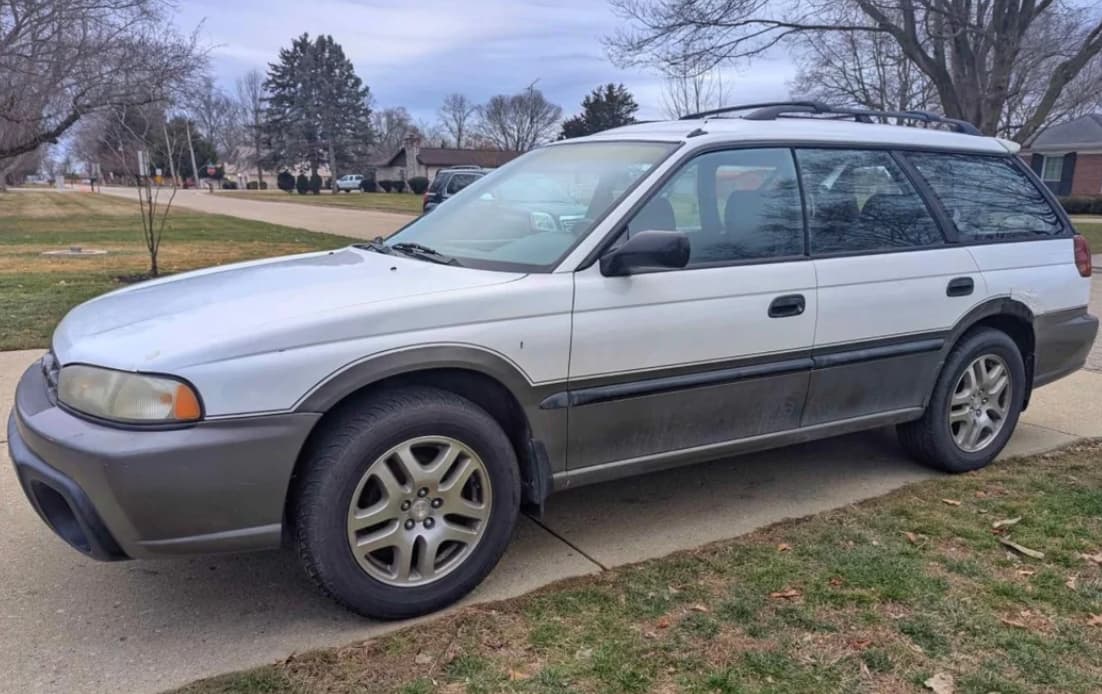

How’s the rear subframe looking?
Pretty much rust-free except for a small spot on the rear wheel well, but nothing structural.

Nice save! You must know a CV axle replacement is cheap and quick, but I respect you for doing the head gasket without pulling the engine. If it’s not a rust bucket, it should last you a long time.
