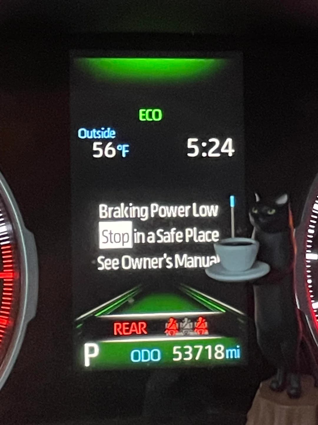

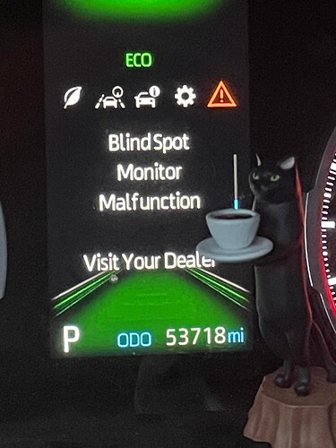

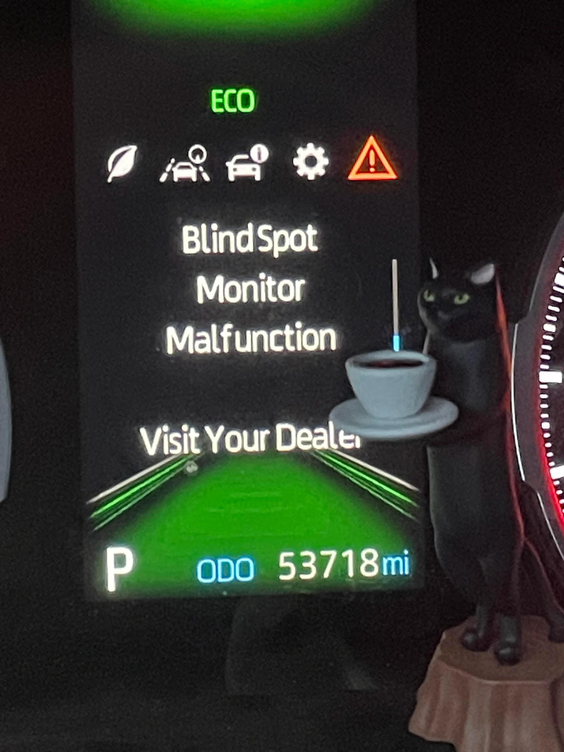

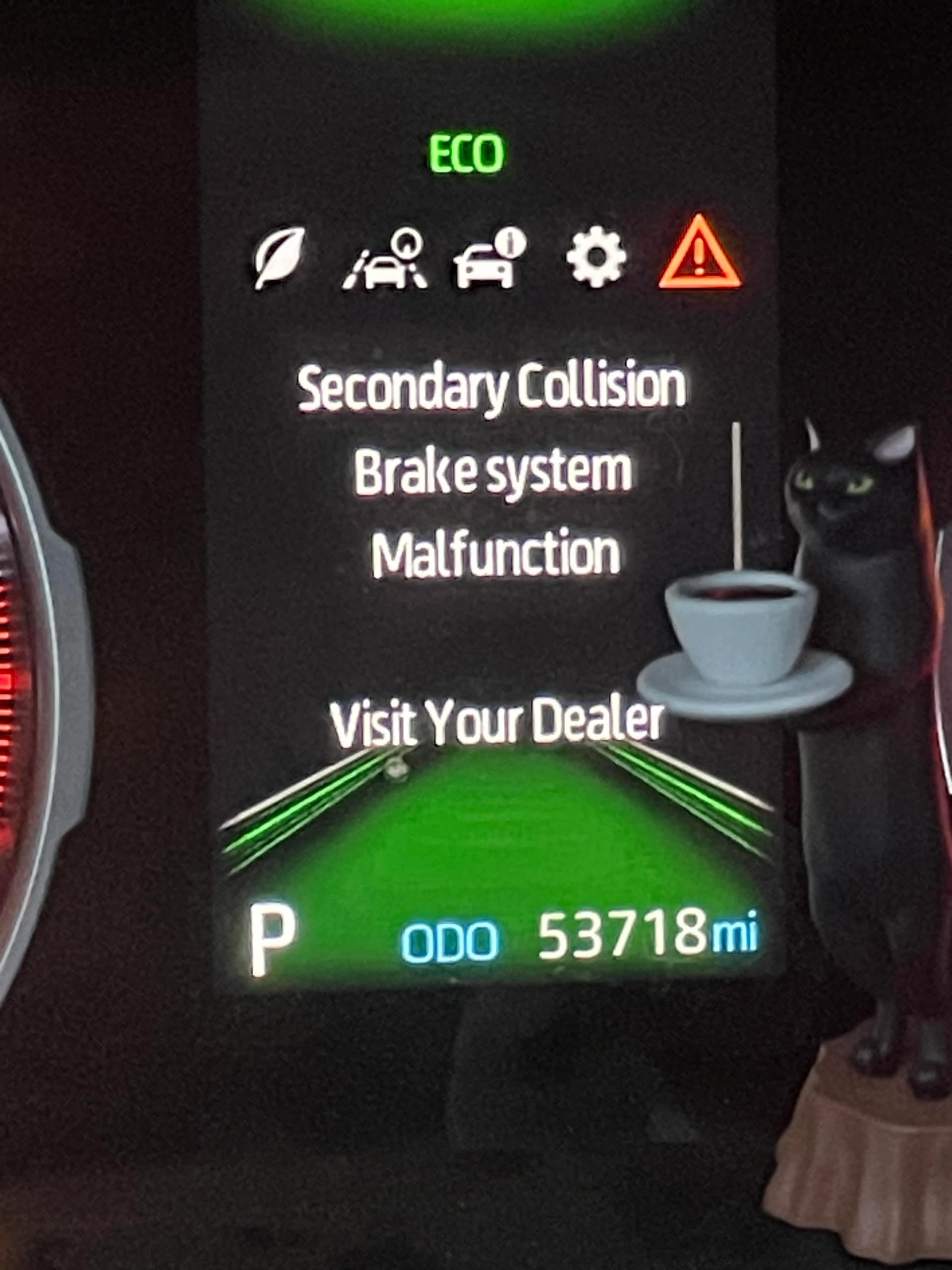

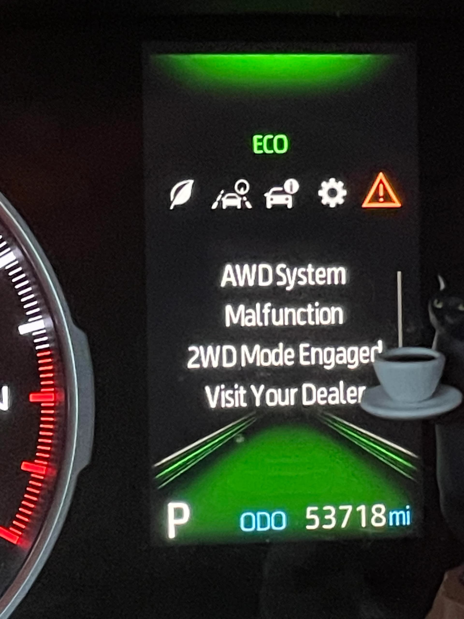

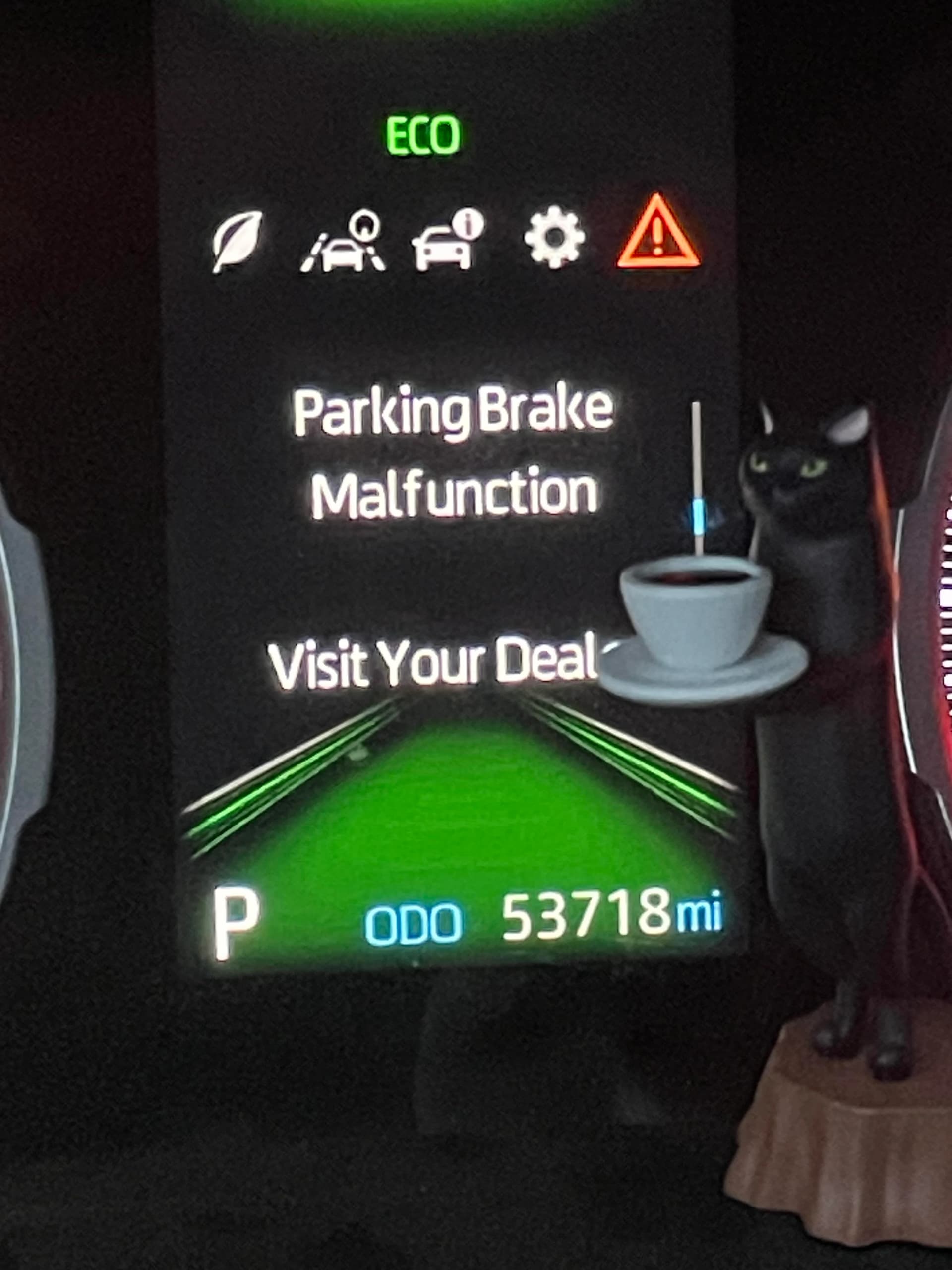

Anyone else get a bunch of random warning lights at once?

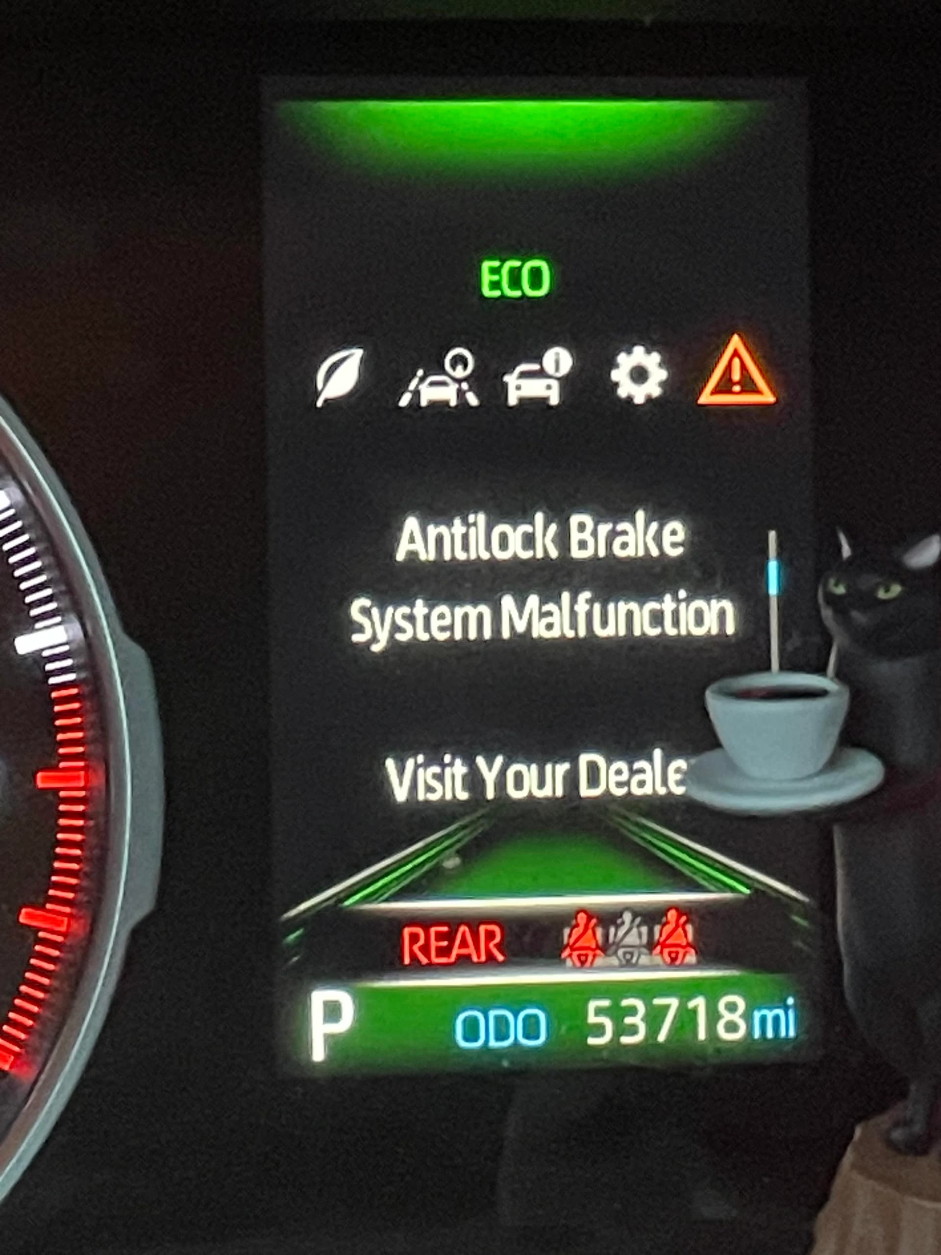

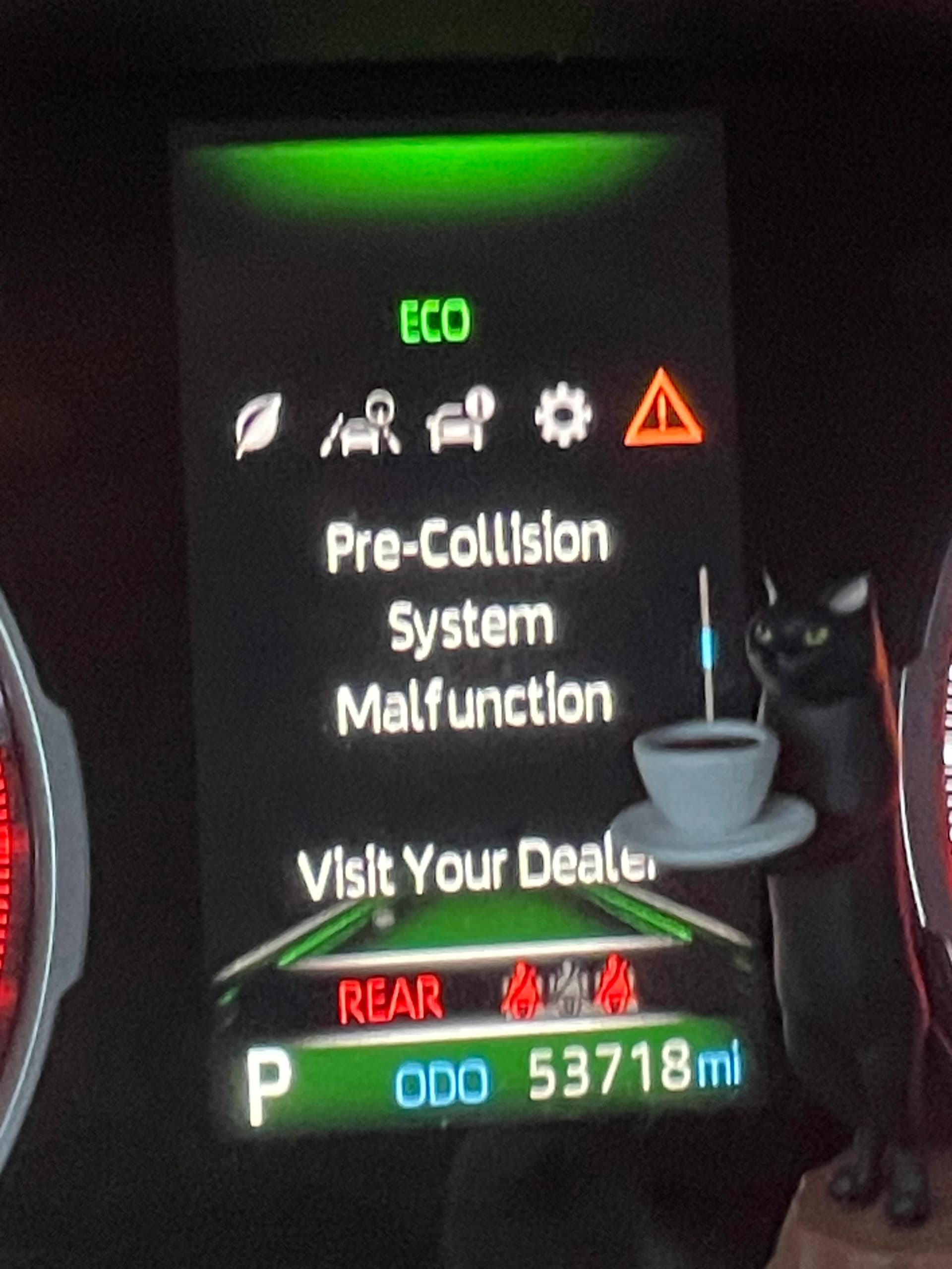

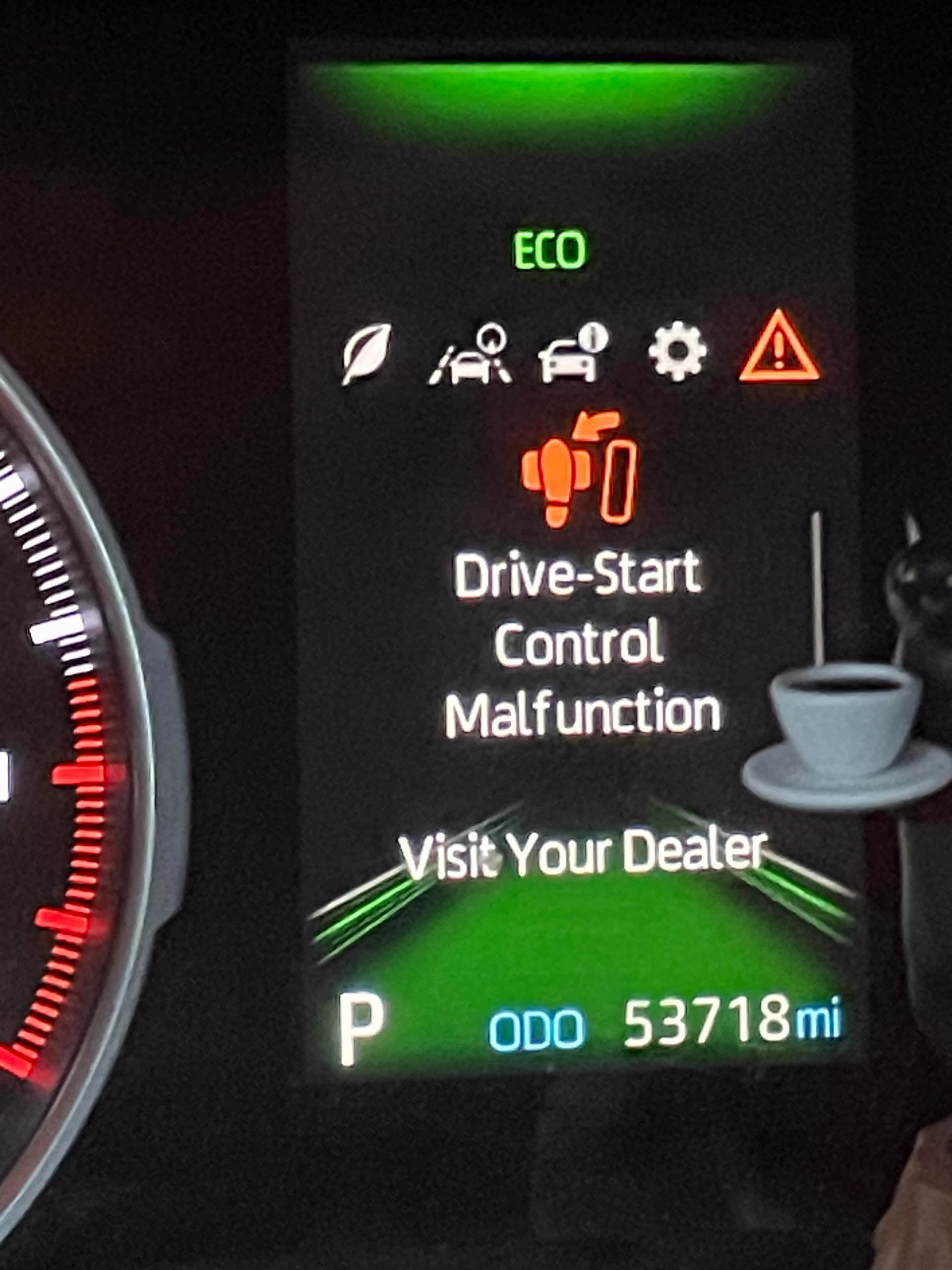

Got a bunch of warnings showing up on my dash today, no check engine light though. Thought it was weird so I snapped a pic. Anyone else deal with this before or know what might cause it?

Get your 12V battery tested. Random warning lights usually mean it’s going bad.

It was actually a rodent chewing through one of the passenger-side sensors :weary_face:

Yeah, turns out there’s a nest in the wiring. They chewed through a sensor and triggered all those errors. Gonna be a pricey repair.
This happened to me too. Dealer first blamed the gas cap but it was actually a wheel sensor that got knocked loose. Once they reconnected it properly, everything was fine again.

I get brake and airbag warnings when it’s hot out, like over 80. Dealer never finds anything because the lights turn off before they look. Could a loose wheel sensor cause that too?

Something similar happened to my CRV. A sensor got stolen and it caused a bunch of errors. I hope yours is just a loose wire and not a missing part.
Is this a hybrid? And do you drive it often? Just wondering since it showed the brake warning too.

Not a hybrid and yeah, I drive it every day.
Bad 12V battery. Same thing happened to me.
