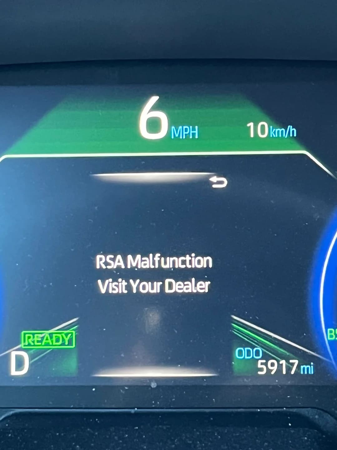

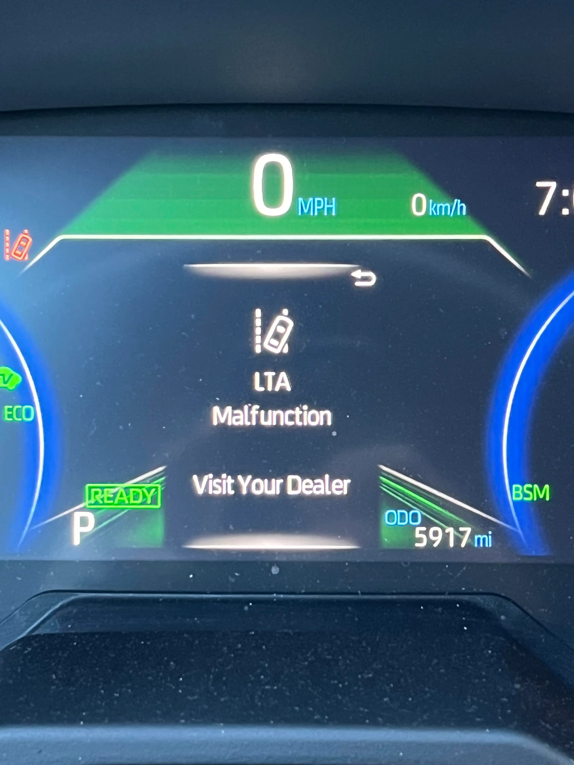

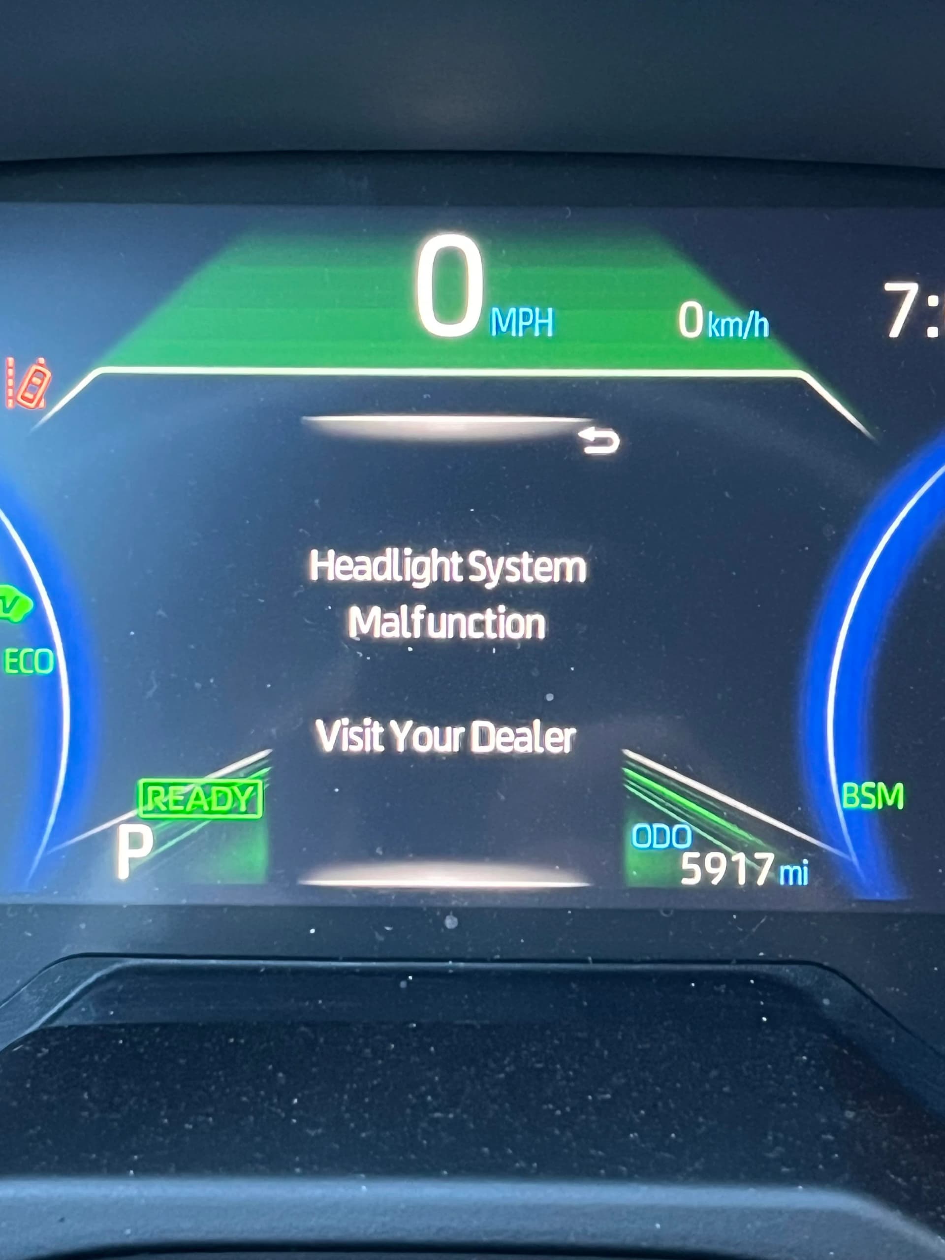

Anyone else getting random warning lights on their 2024 Hybrid LE?
Woke up this morning and my 2024 Hybrid LE started throwing a bunch of warning lights.
The car runs fine otherwise, but this keeps happening off and on. Anyone seen this before?

Looks like anything that needs the front camera is having issues. Could be something blocking it or maybe the camera’s just acting up with heat or cold.
Same thing happened with my 2023 Hybrid Limited. Took it to the dealer and they found the front camera was bad. They replaced it under warranty and it hasn’t come back since. Took a couple weeks for the part though.

Same thing happened on my 23 LE Hybrid. Tons of warnings at startup but everything cleared after driving for a bit. Dealer said my 12v battery was low. After a few longer drives, the problem went away.
Had the same issue. Ended up being the lane assist camera.
Dealer knew what it was right away. It was in my system alerts. Only problem was the camera was on backorder for months. Took five months to get it replaced. Hopefully you won’t wait that long.
They’ll probably need to replace the front camera. But for warranty, they’ll want to see the failure code first before they can do anything.
