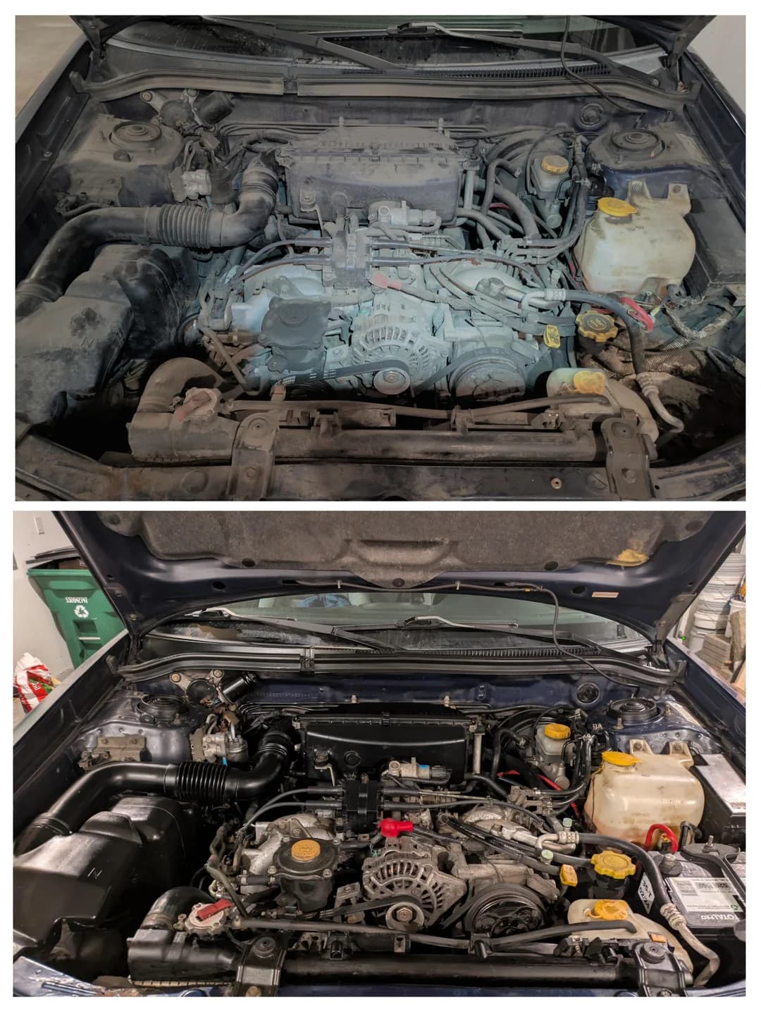

Glad I snapped a before pic… didn’t expect the difference to be this crazy. Spent about a week working on it in between fixing other stuff. Pretty sure the engine bay hadn’t been touched in over 12 years.
First, knocked off loose dust with a paintbrush.
Then went in with wet towels, brake cleaner, electronic cleaner, and small brushes.
Looked decent at that point, but a little trim conditioner really made it pop.

Just a heads-up—let the engine cool completely before spraying it down. Some sensors crack if they cool too fast.

Good tip, hadn’t thought of that. Should be fine though, no hose involved, and it sat for days before I did the deep clean.

Why did everything look kinda blue before you cleaned it?
Kelby
March 10, 2025, 11:49am
10
Not the original poster, but I’d bet they had a flashlight shining on it, making it look blue in the middle.

Yeah, it was my headlamp. Also, it was dark.

Can you use a pressure washer for this?
Wren
16
A lot of people say ‘NOPE.’

What did you use for cleaning?
I want to do this, but I’m worried I’ll wreck something. Any tips?
Flynt
19
I mostly followed this video .
