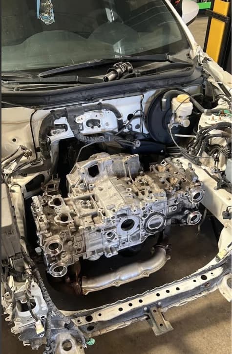

Anyone ever swap an EJ into a BRZ…? Well, I did
Outfront makes a shallow oil pan if you’re worried about scraping.
Their prices are wild haha. I’m just gonna modify the stock one, make my own baffle, and shorten a Killer B pickup.

Dry sump? This setup is looking tight.
Dolph said:
@Brook
Nah, just an Accusump for now. Gotta stay within budget.

Budget builds always hit different. This thing looks solid.
@Brook
Check their page, they also sell a shortened Killer B pickup, and it’s not too much more than the regular one.

Would the stock BRZ transmission work with an EJ? Not sure which one would last longer either way.
If you can find an STI 6-speed, that’s probably your best bet. But from my experience, the 5-speed goes out first.
That said, the 5-speed might actually be better for drifting since the longer gearing lets you stay in first and second longer.
Yeah, the BRZ trans can work, but you’d have to modify either the block or trans to mount the starter. Not really worried about longevity, though. This thing is gonna be driven hard.

This is so cool. Now someone just needs to swap in an EZ30 or EG33 for maximum chaos.
There are a few people who have pulled that off! But my heart belongs to turbo EJs.
Man, I thought I was the only one dumb enough to paint my EJ white :joy:. It’s clean like twice a year.
Paint? Nah, it’s just a clean block haha.
Brook said:
Also, good lighting helps.

Oh damn, fooled me! In the pic, it looked painted.
