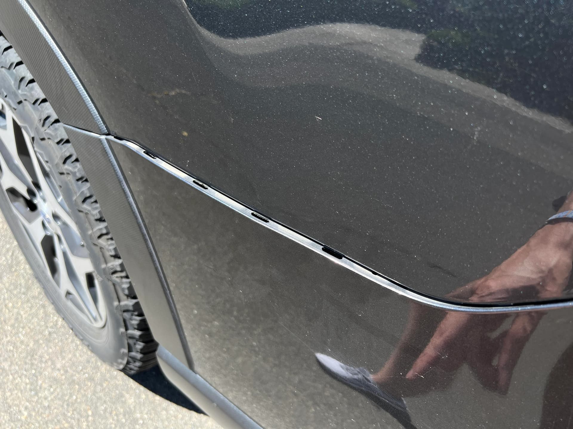

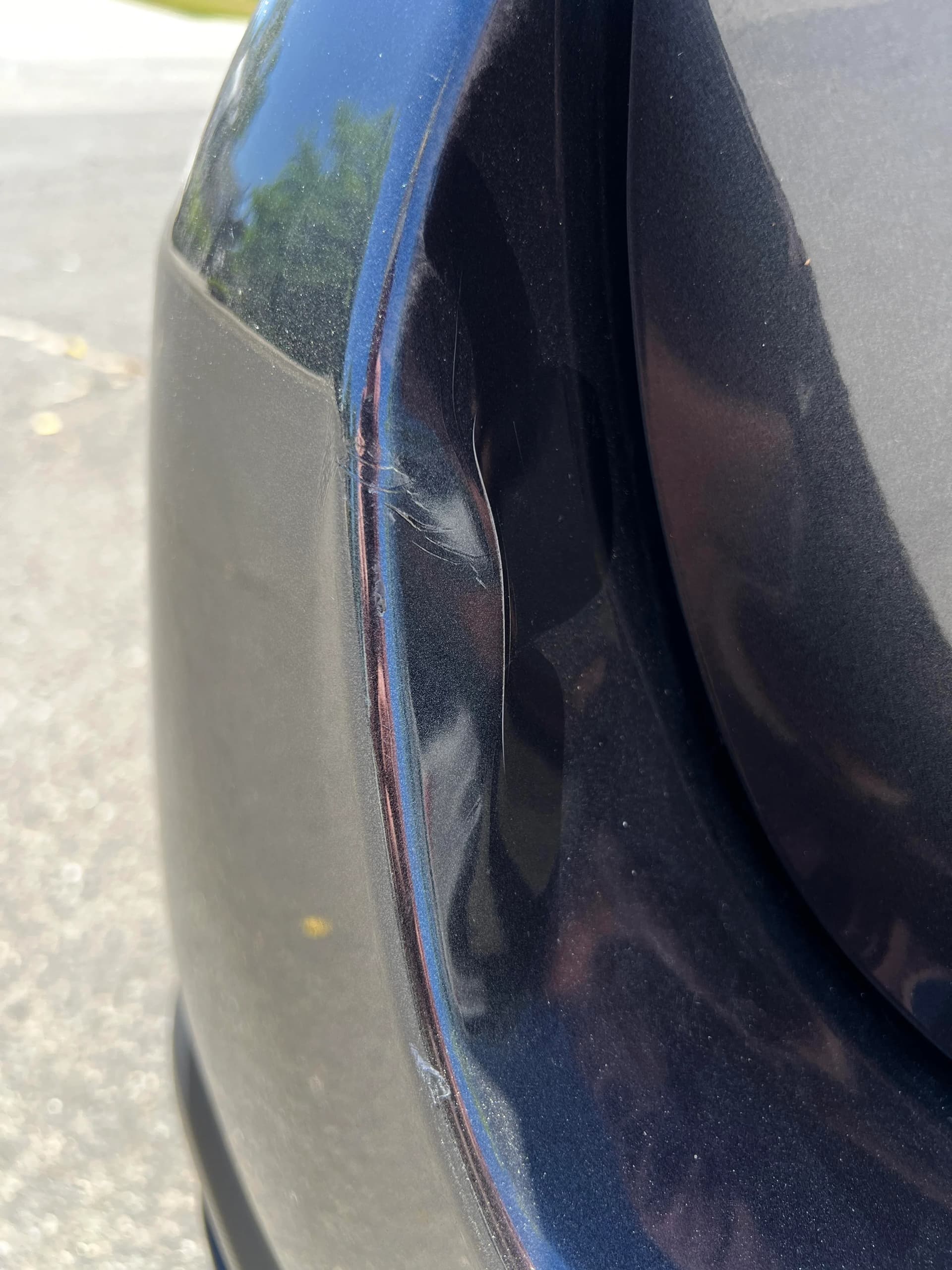

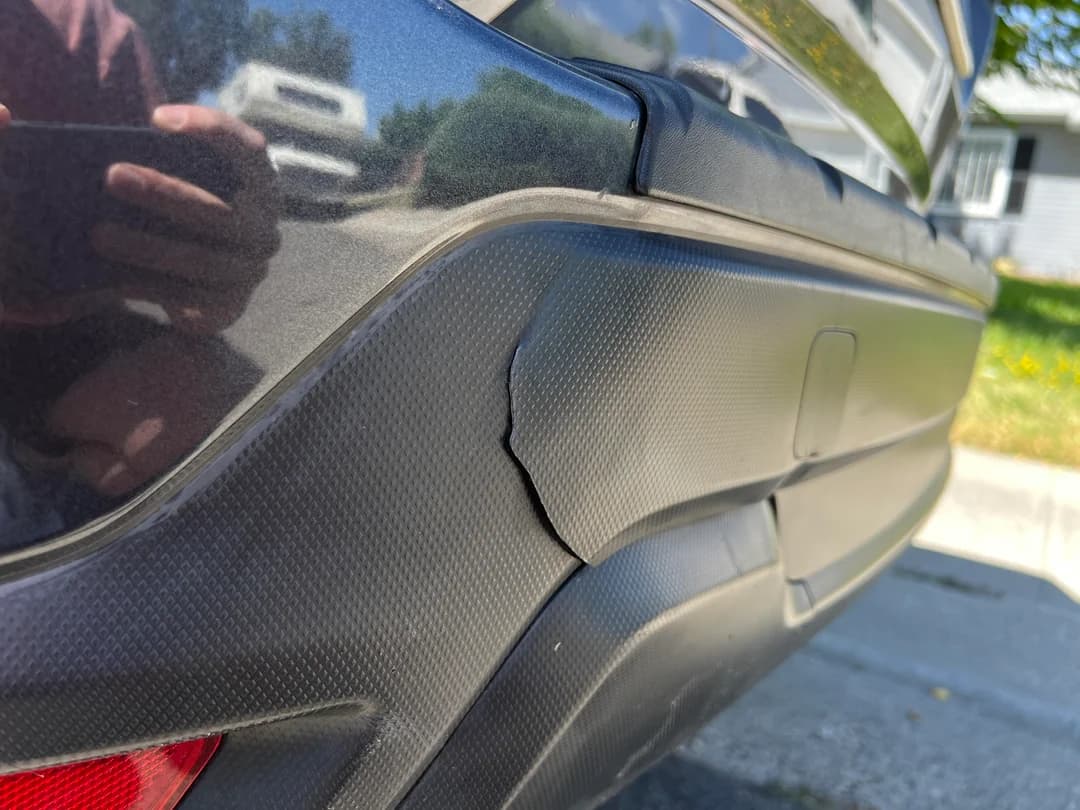

Got rear-ended at a stop sign, not my fault. I have a $500 deductible, but they have insurance and shared their info. They also offered to pay me directly.
Has anyone dealt with this before? Is it better to go through insurance? How much did it cost you?
2019 Subaru Forester.
Appreciate any advice—thanks

I replaced mine about a year ago. If none of the sensors are damaged, you can probably do it yourself for around $200. My buddy at the dealership said if an RBU sensor is messed up, then the cost goes way up.
From what I see, looks like yours is cracked with a couple of broken attachment tabs.
Not sure about that body panel near the hatch, though.

The damage might be worse than it looks. Check underneath—see if the frame is damaged, look at the actual bumper bar, and check the trunk pan for creases. If anything structural is messed up, it won’t protect you the same way if you get hit again.
If you want to fix it yourself, the crack in the bumper can be plastic welded from the back. The side of the bumper might snap back into place with some force. You can try heating the dent with a hairdryer or heat gun to pop it out—just don’t overdo it and mess up the paint.
For paint, you could try a touch-up kit from Subaru, but a professional paint blend will look better. Or just have the whole thing done at a shop. Depends on how perfect you want it to look.
