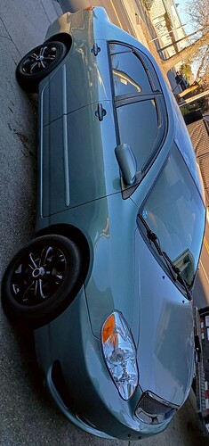

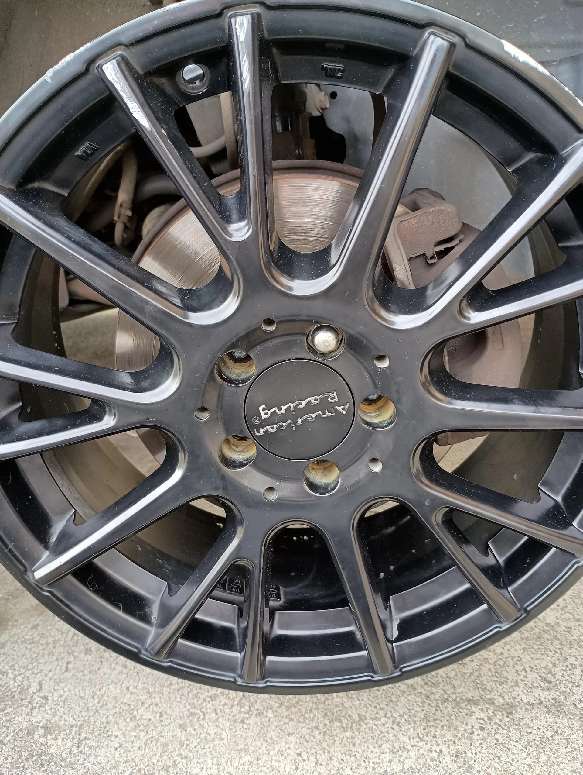

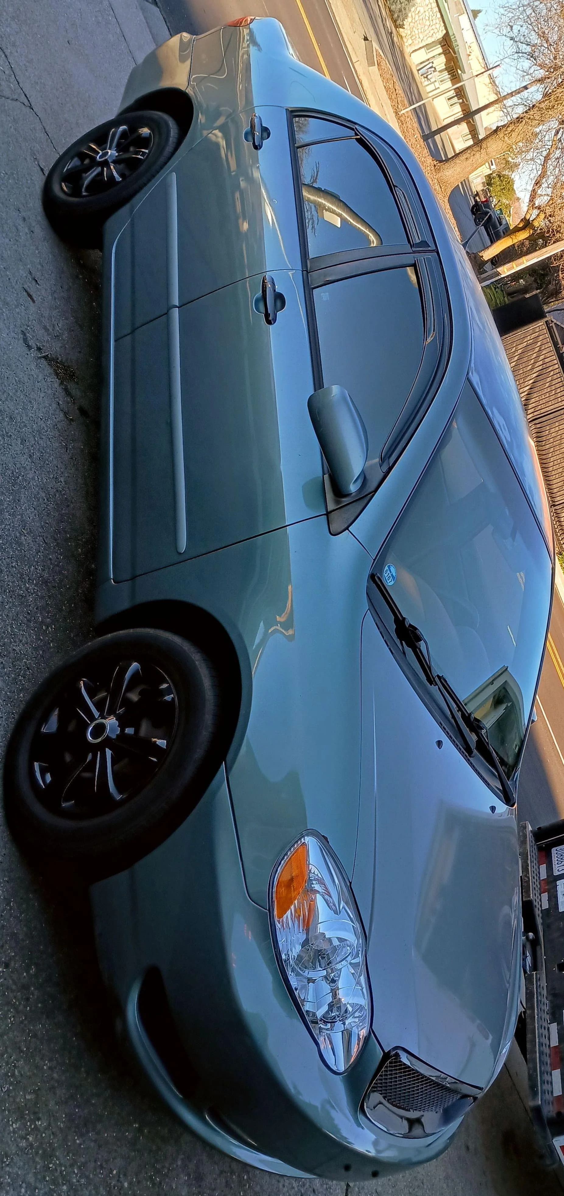

I have 17" rims, and while the studs fit into the holes, they seem pretty short. Do you think they’re long enough to secure the rims safely? Also, the lug nuts I’m using for my stock tires fit, but there’s not enough space for a wrench to tighten them. Can anyone let me know what I need to get to make these rims work on my 2007 Toyota Corolla LE? Thanks!

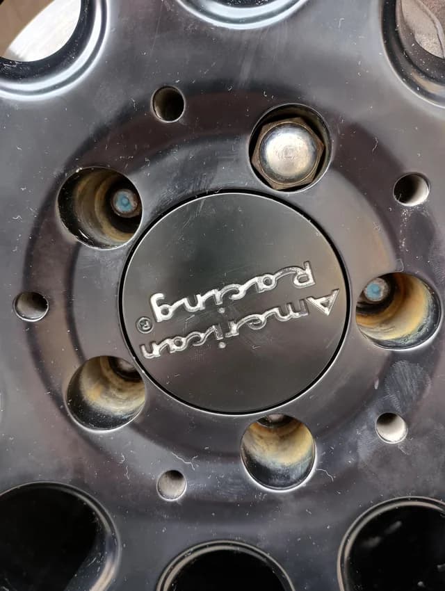

Do you think I can use the stock studs? I don’t know if I can get 3-4 turns on them.

Do you think the stock studs will work with those extended lug nuts? People keep saying I need at least 6 turns, but I don’t know if I can get 3-4.

2019 Corolla hatchback, different rims than what you have. But all Corollas should have the same stud size. They all have the same bolt pattern. Yes, it’s safe with the stock studs. Quick question: can you give me an estimate of how much stud is sticking out? Are you able to feel some of the threads? If so, you’ll need extended ones. Regular tuner style lug nuts may only grab a few threads. You can check the link I posted in the first comment and use those measurements to search for them online. Maybe call a couple of tire shops to see if they have them in stock.

Look through the photos I posted, you can see roughly.
Dallas said:
@Montana
Oh, then yes, you’ll need to order the ones I sent you from Amazon. Or check if your local auto store has them. Autozone can be hit or miss, so try Advance Auto or O’Reilly’s.

You’ll need new wheel lugs. I’ve always heard that the minimum is 6 full rotations of the lug nut.
How many threads are engaging with the lug nuts? There’s probably a minimum requirement, and personally, I’d hate to be at the minimum. It looks like while the bolt pattern is the same, the offset is way off. It might be safer or more cost-effective to sell these and find better fitment. If you’re set on keeping them, you may need different lug nuts, although I’m not sure which kind. Good luck. If no one here knows, try taking them to a local tire shop for advice.
