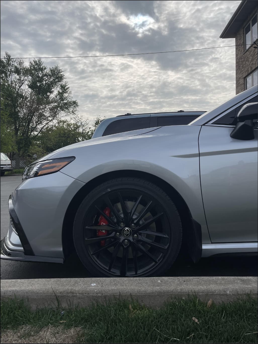

I upgraded my 2024 V6 XSE with GR Corolla front calipers.

Total cost for the project was around $1082 (not including spacers):
  • GR Corolla calipers: $200 each, so $505.49 for 2 (part numbers below):
    • 47750-52400
    • 47730-52350
  • IS500 Lexus rotors (2022+ model) from rockauto.com: $75 each, total $165.01 with shipping (PN 304074028)
  • GR Corolla brake pads from rockauto.com: $42 for the pair, but I ended up getting everything from Toyota for $146.55
  • Front brake pad set: 04465-52370
  • Fitting kit set: 04947-52080
  • Shims: 04945-52210
  • Custom brackets from 350phi: $279
I also needed a set of H&R 5mm wheel hub spacers, which cost about $120. The stock XSE wheels wouldn’t fit the caliper without them. It’s a straightforward job, the braking power is much better, and they look awesome.
