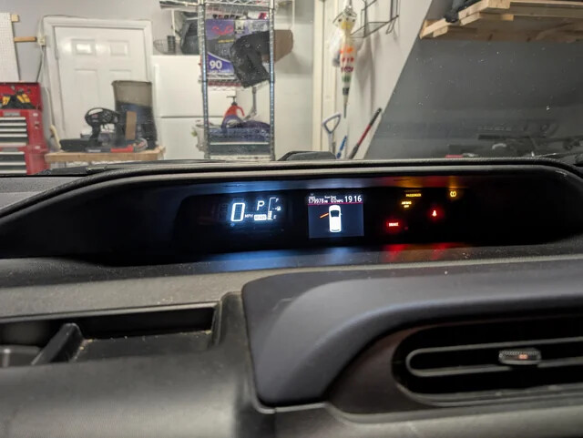

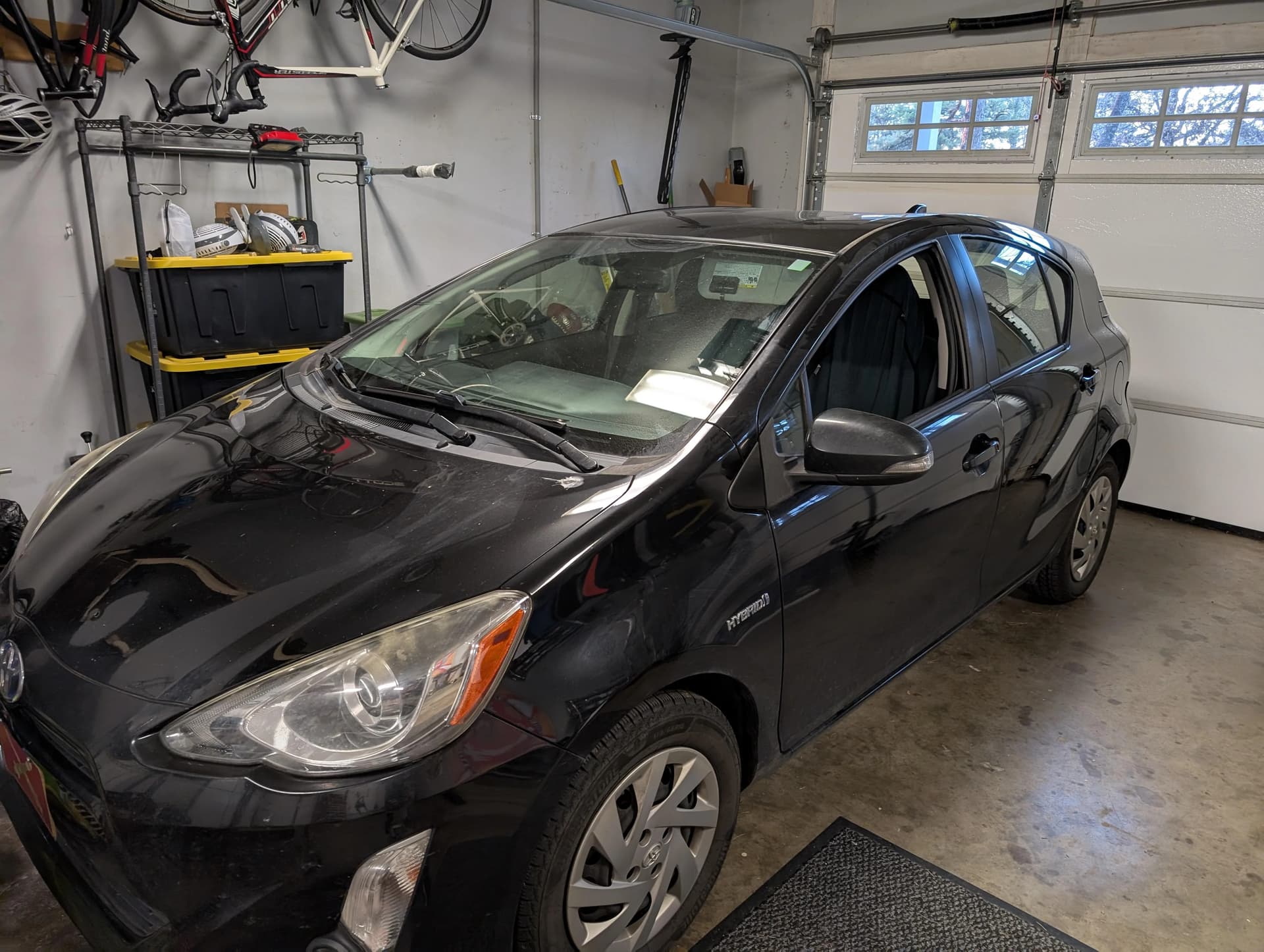

My 2015 is at 320k miles now. I usually change the oil every 13k since I bought it at 58k (it was an ex-rental car). Never had oil loss issues, and lab reports say it’s fine to go even longer, but 13k is where I draw the line. I only use Mobil 1 ‘High Mileage Advanced Fuel Economy’ with OEM filters.
