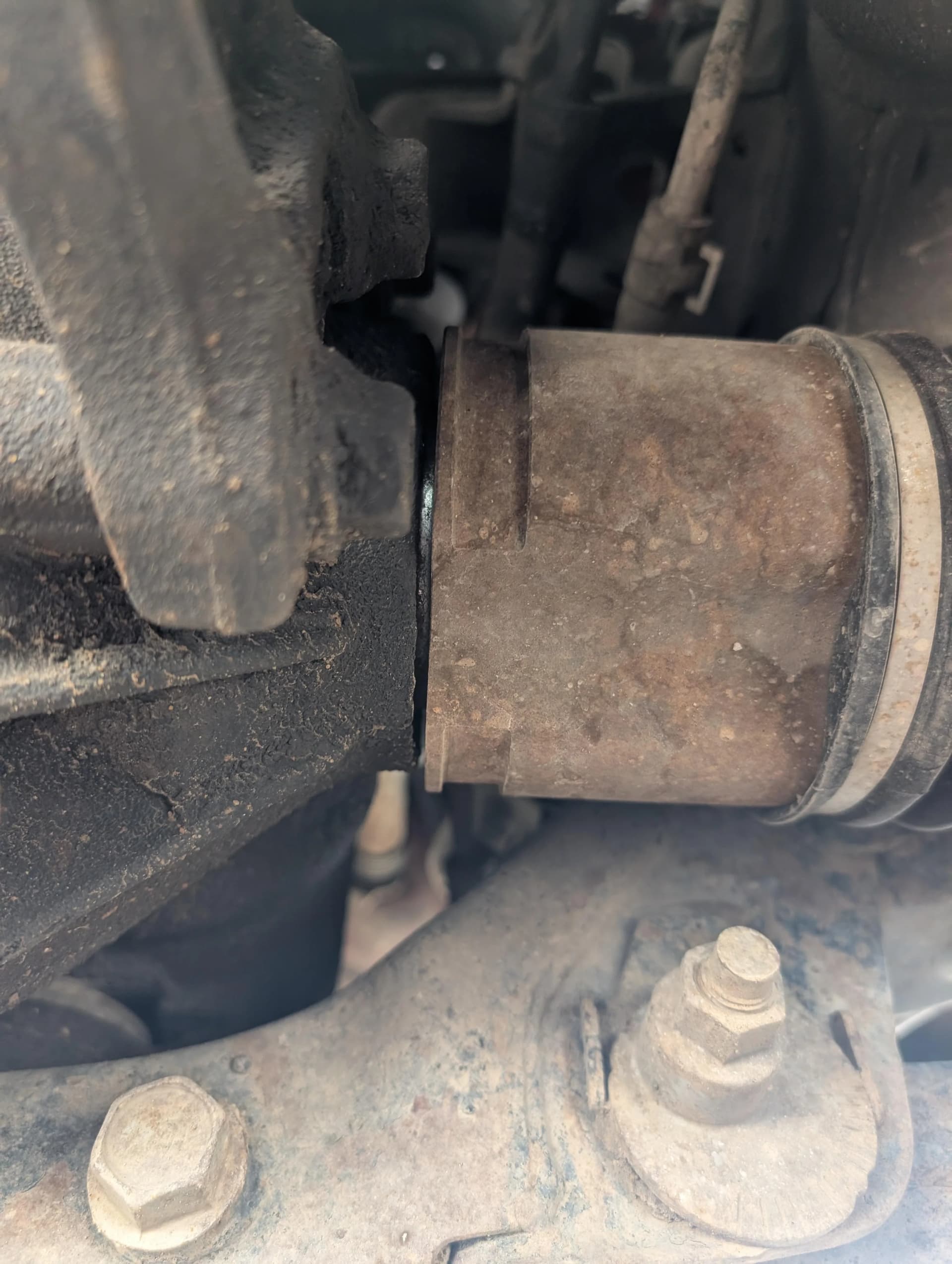

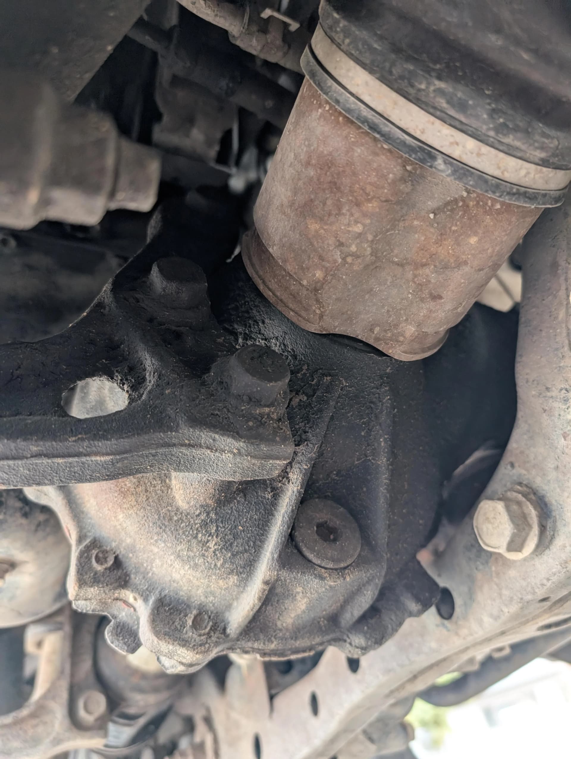

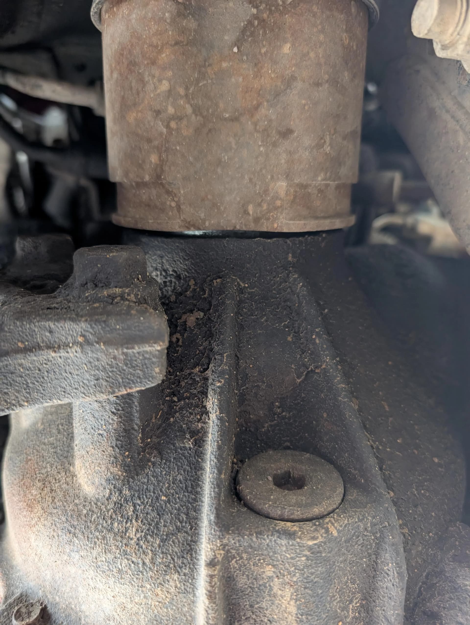

Is this an OEM CV axle or aftermarket?
Yeah, looks OEM to me. The way I tell is the notches in the axle housing near the differential. Aftermarket ones usually don’t have those, which makes them a pain to remove.
Good to know, thanks! Mine is shot, so I want to replace it with an OEM one. Just making sure so I can get my core deposit back on the new one.

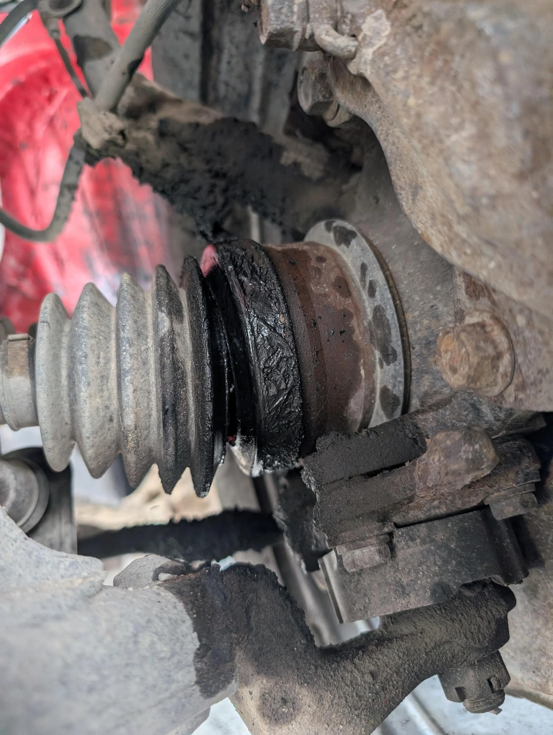

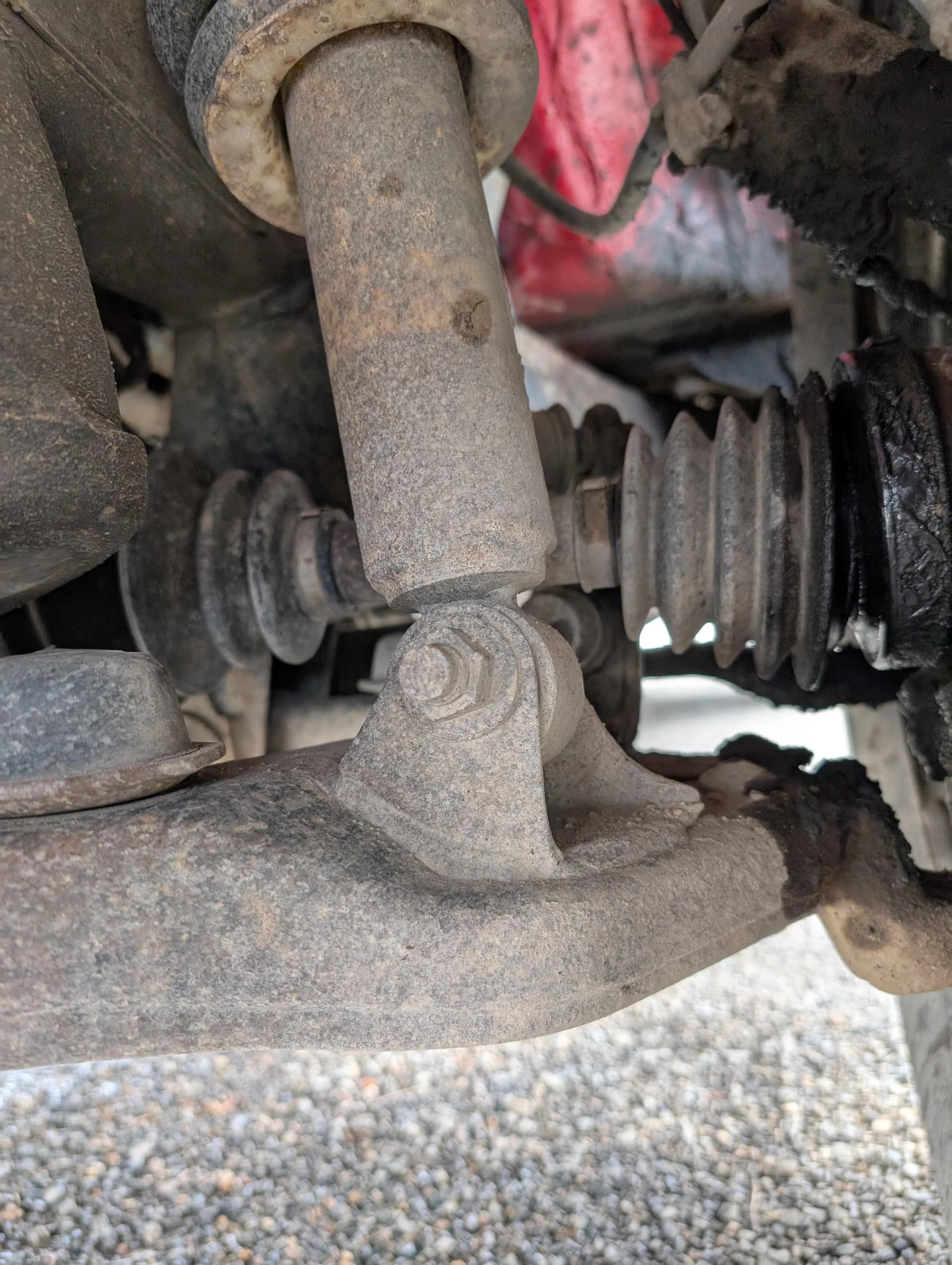

Yeah, I agree. A rebuild is usually the best option. They rarely get so bad that they can’t be fixed. From what I see in your pic, it looks like it’s just leaking from the outer boot. They’re actually kind of cool to take apart and look at.

Looks like OEM to me. One way to check is by feeling the outer boot (the one near the wheel). It should be a stiffer rubber than the inner boot.
By the way, it’s a 2004 Tacoma 4x4 if that makes a difference.
If it was replaced with a remanufactured axle at some point, there’s no way to tell. But if it’s original, then yeah, it was OEM.
