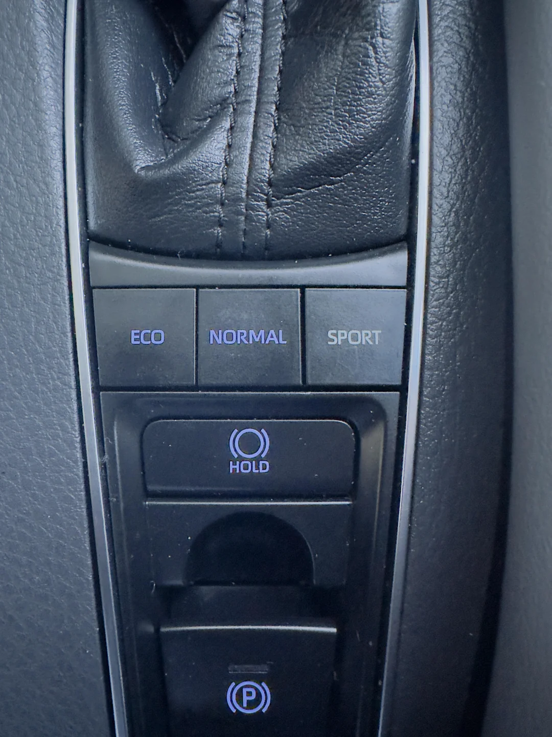

Good morning, everyone! My sport button doesn’t light up. Is it supposed to? If so, how do I replace it? Thanks in advance…
Hey, saw your post on FB!
The LED is probably bad. Unfortunately, it’s soldered to a board and not user-replaceable. You’ll likely need to replace the entire piece. Search for “center console gear shifter trim panel” for your Avalon model and year.

Thank you! It’s so expensive for just a blown bulb.
All right, everyone, I figured it out. Yes, all the buttons are supposed to light up. I took everything apart, and there is no bulb—just something that looks like a module soldered to a board. I ordered a Camry panel because it looks exactly the same and is way cheaper on eBay. Plus, the only ones I could find are for hybrids. When I get the part, I will share my experience to see if it works or not. Everything comes out by snap, and the shift knob has a little wire that you pull out. I will share pictures when I go through it again.
