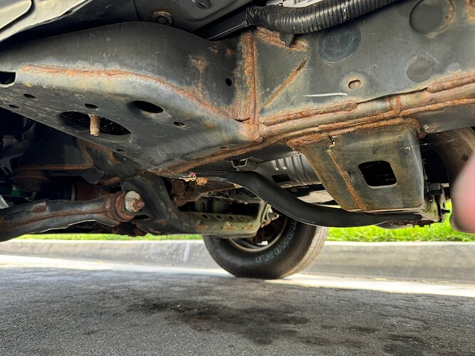

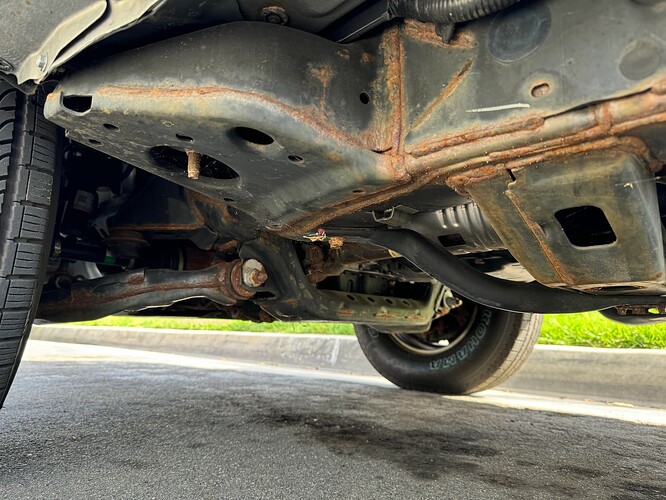

Surface rust in California… is this even a problem?
I’d hit that with some Fluid Film and forget about it. I do it every year up here in the cold, no big deal.

But seriously, just get it undercoated. I do mine every fall for $125 and it holds up fine.

I’m in NJ and that’s not rust. Just hit it with some Fluid Film and move on.
If it bothers you, wire brush it, throw some rust converter on there, and hit it with Rustoleum. Easy fix.
Honestly, this isn’t something you need to stress over. Cars in CA last forever compared to the rust belt.

Yeah, I live in CA and this is rare here. I’ve got three cars from the 90s and none of them have rust like this. My ‘96 Tacoma’s frame looks new compared to yours.

If I just leave it alone, will it get worse fast in CA?
Akira said:
Are you parked right on the beach or something?
@Cassian
Nope.
Akira said:
@Cassian
Nope.
Then you’re fine. No need to stress about it.
Look into dry ice blasting for rust removal. My son is getting it done on his Gen 2 Tacoma soon. Works great.
