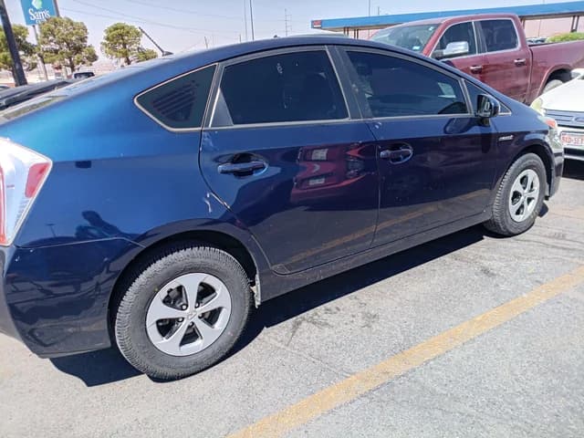

Just sharing a shot of my ride after the lift and tire upgrade. Looks great to me.
Looks solid… here’s mine for comparison.
