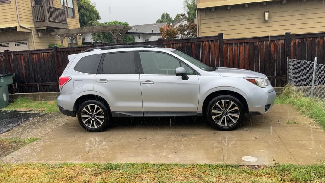

Thinking about upgrades for my 2018 2.0XT… any ideas?
I just got a stock 2018 2.0XT with 68k miles, one owner, and all the regular maintenance done at the dealership. I’ve mostly had older Wranglers and diesel Rams, so this is a new experience for me.
I do all my own work, from upgrades to welding, so I’m looking for tips on what to watch out for and any maintenance that’s not so obvious. It’ll mostly be a daily driver, but I’ll also use it for light off-roading, camping, and towing small stuff.
Besides swapping out the head unit (still looking for one I like), are there any must-have upgrades? I want to improve fuel efficiency while adding a bit of durability.
