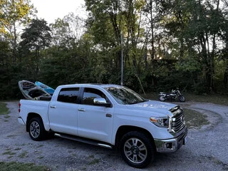

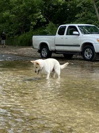

Rt on…. My first tundra was an 06 SR5. She is still going strong at 180k. My daily driver work truck. So I knew what I wanted when I got the 1794.
