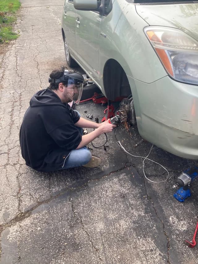

Tried everything to get the wheel bearing out… still stuck
My mechanic friend might be able to help me soon with a slide hammer, but right now I’m completely stuck.
If anyone has tips on how to get this wheel bearing out, I’m listening.
We already tried hitting it with a sledgehammer, heating it, and prying at it. Still no luck.
I’m honestly ready to light some incense and hope that helps.
It’s an 08 Prius from the rust belt. Everything’s fused tight from years of salt and grime.

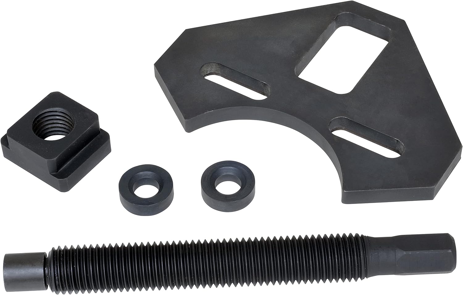

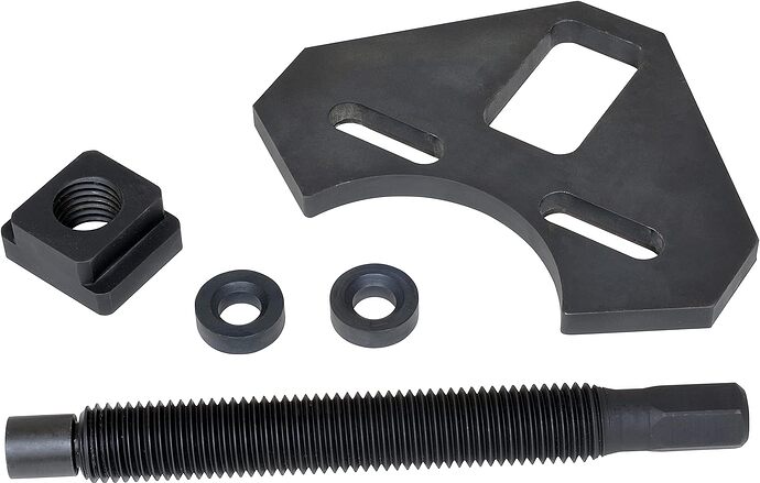

Glad you got it sorted. I just finished both front bearings on my 08. This tool really helped and was totally worth it. Got the idea from Eric O from South Main Auto. Just remember to get the rear bolts off first.
