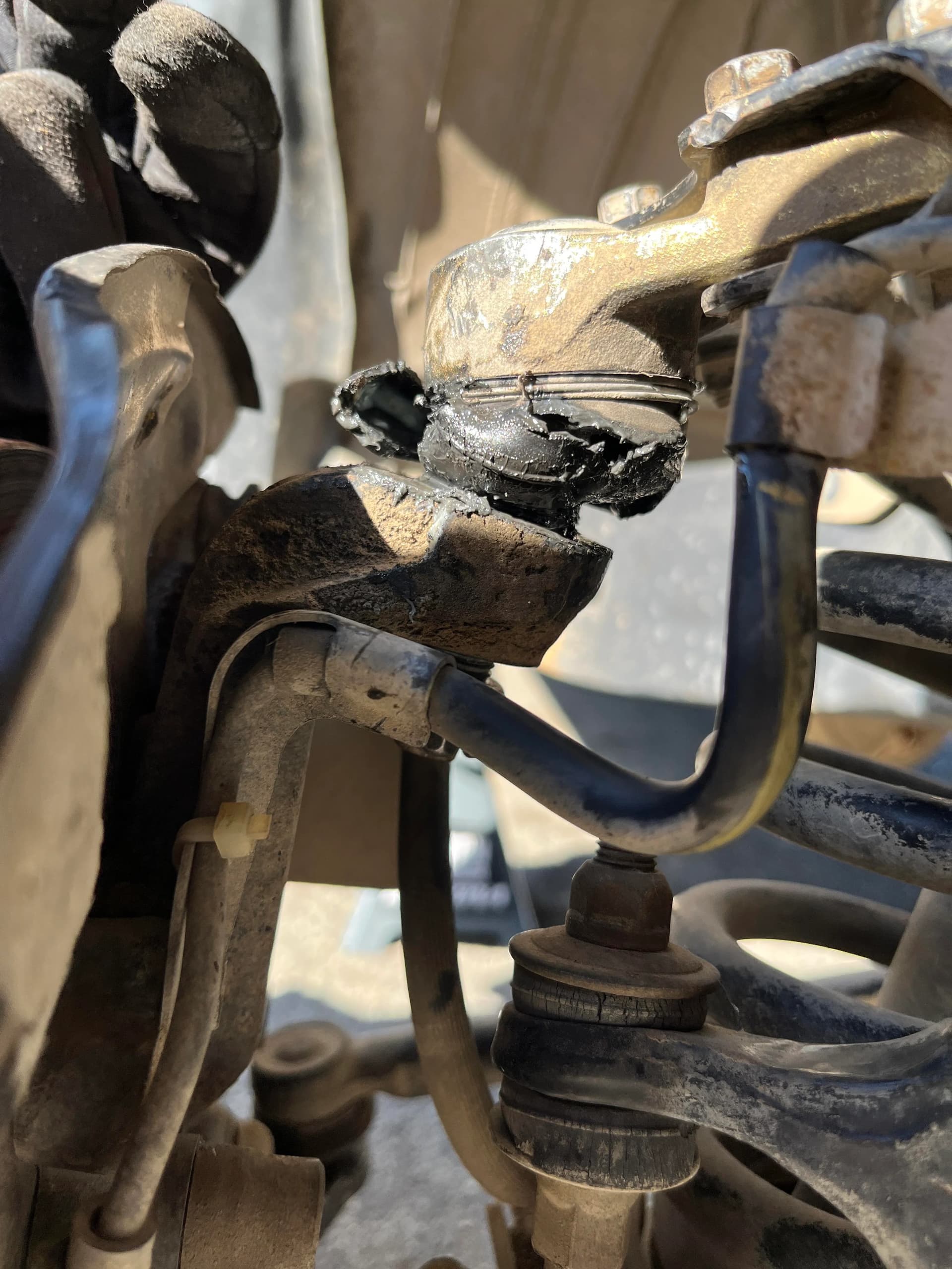

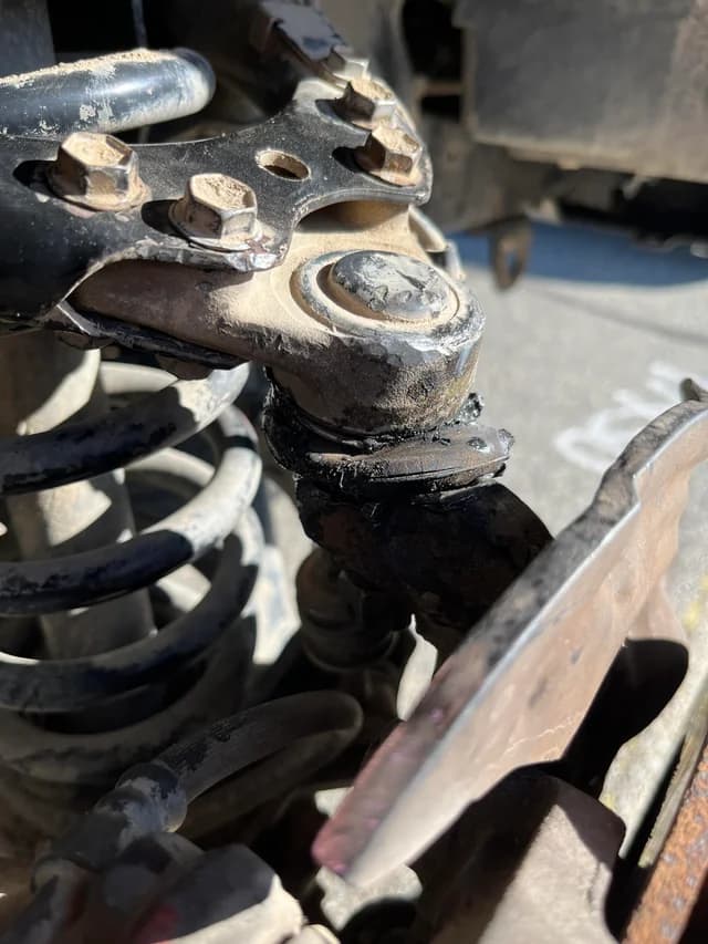

Trying to change upper ball joint… need some help
A ball joint press should do it… heat only if nothing else works.
Did you take the circlip off?

There might be… if everything else is free, I’d cut off the threaded part with a sawzall, then rent a ball joint press from the parts store.

The new one didn’t come with a circlip. I got the castle nut loose, gonna try a pitman press tomorrow.

Keep pressure on it with the pitman press while you hit it or heat it up.

Just a heads-up… I broke two of those rental presses (the reverse scissor kind) before switching to a pitman.

After looking closer, I don’t think yours has one. The whole joint and bracket should slide out after unbolting. If it did have a circlip, it’d be between the boot and the joint.

Haha, fair question… I’ve been using a 3lb sledge. Got the lower one out with it, and the tie rod gave up pretty quick too.
@Fern
That should be big enough… maybe have someone pry the upper control arm up while you whack it.

Got it… I’ll try giving it a little push while hammering.
You’re using a pickle fork? C’mon, man, it’s 2025… just get a proper ball joint separator. It’s worth it.
