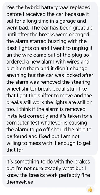

I just got this Prius, but it only starts when I jumpstart it. Once it’s running, the brakes are really stiff and there’s no power steering. The hybrid battery seems to be holding a charge, though. The previous owner mentioned they messed with the alarm system and put in a new one. Any idea what I should check next?

Sounds like the brake booster might have failed and set off some kind of alarm, which could’ve led the previous owner to mess with the alarm system and make things worse.
Would that explain why the battery doesn’t charge at all? I dropped the 12V battery off for testing and it was only at 3V. Makes sense why it won’t start or have any lights without a jump. Can it really just be a bad battery though?
