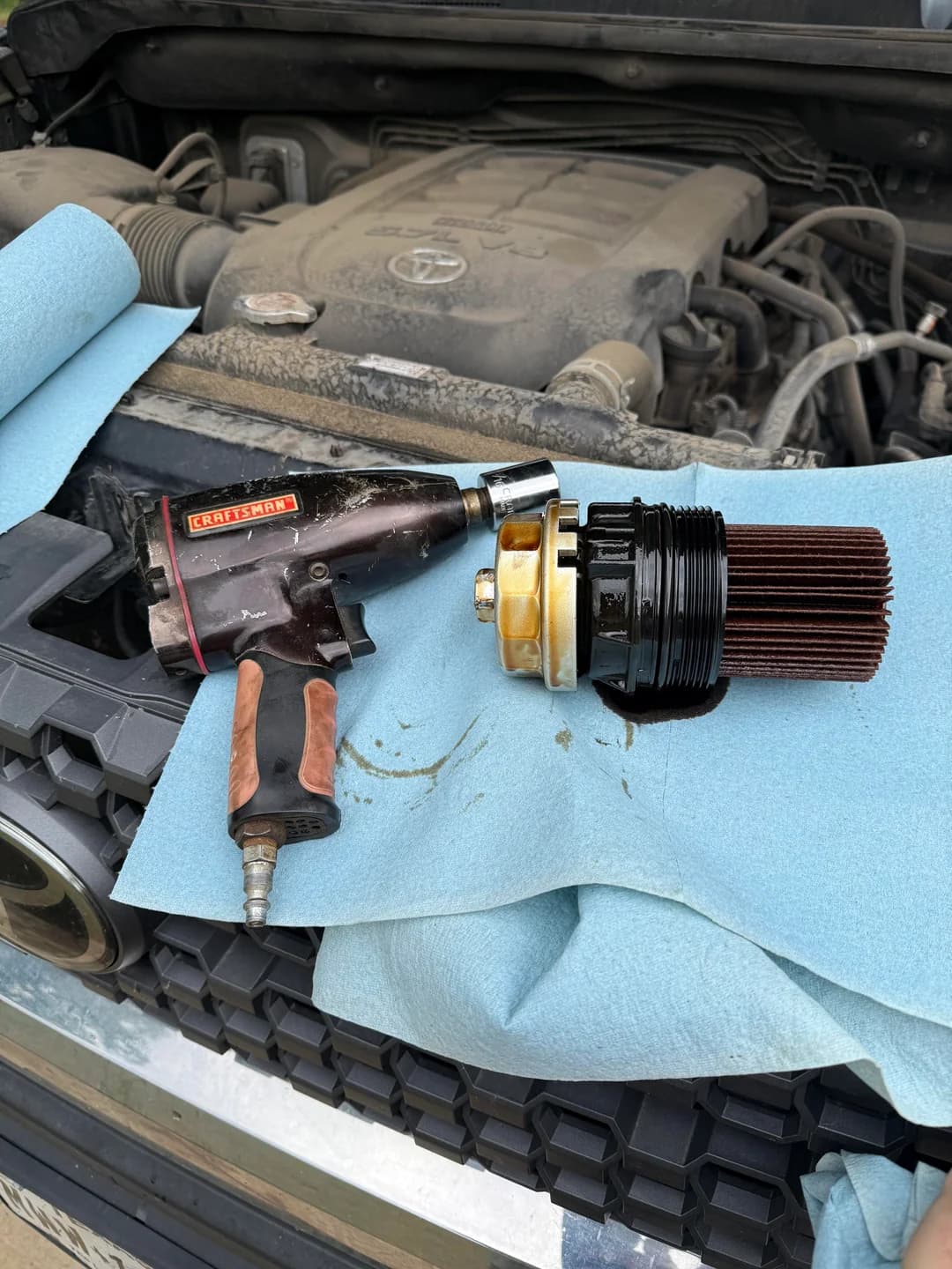

I would like to ask Toyota Engineers: What was wrong with the metal canister oil filters? I love my Tundras, but I have always HATED the new style filters. I had a dealership change the oil last time out of necessity, and this time I could NOT get the plastic cap off to replace the paper filter.
I started off with my filter wrench, and a 12” ratchet, and it wouldn’t budge. I then moved up to a cheater bar and still couldn’t get it. I finally had to move up to my impact wrench, and was very scared of breaking the housing. Luckily, it came off but even the impact struggled.

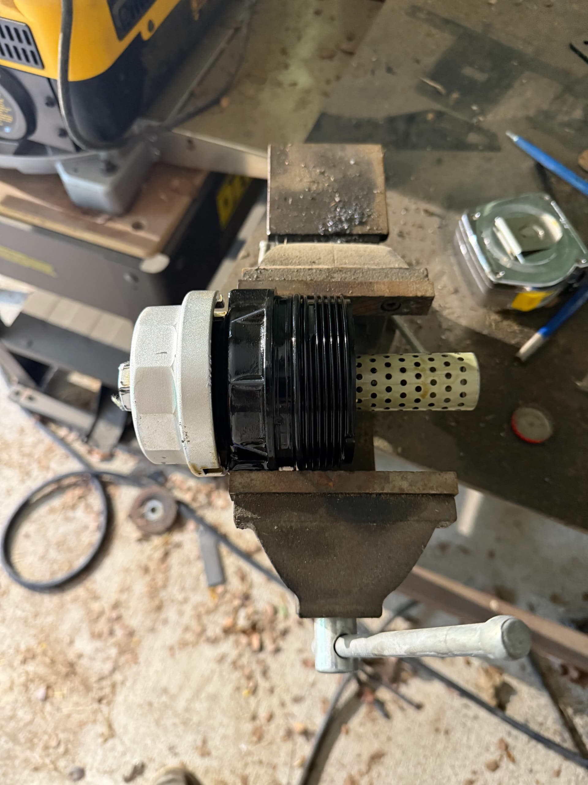

To get the filter wrench off, I had to put the cap in a bench vice and drive it off with a punch. I’m not sure if others have had this struggle, but I have always hated these filters. This was way more work than it had to be, and the complexity is getting beyond the average homeowner.

I didn’t know there was a metal option. I’ll check that out. I’ve had my impact for years, got it as a Christmas gift from my parents. I really love my tools.
