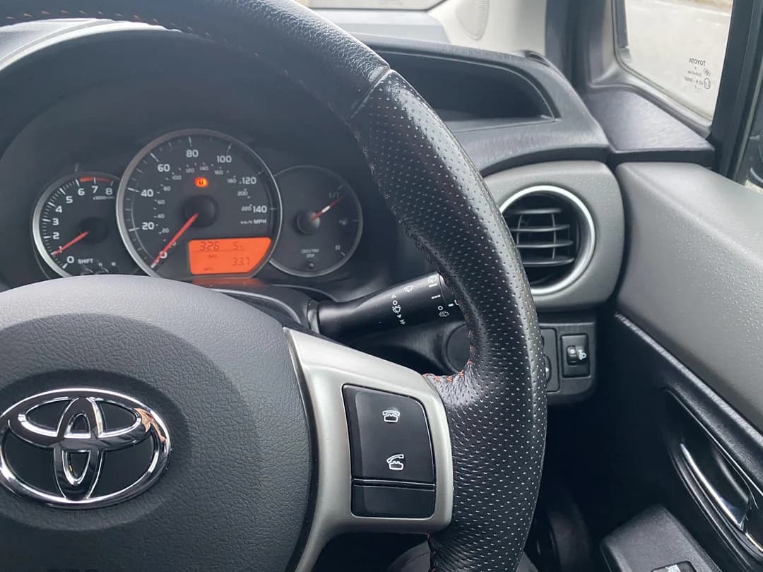

I’ve got a 2012 Toyota Yaris MK3 1.3L manual. The driver-side vent doesn’t blow warm air, but all the other vents (middle and passenger side) work fine. Coolant levels are good, and I’ve checked the radiator too. What could be the problem?

I tried closing the other vents, but the driver-side vent still blows cold air while the rest produce warm air.

What settings are you using on the climate controls? Can you upload a picture of the panel?
@Keelan
I tried again today. Left the car running for 10 minutes with heat at max. Closed all vents except the driver-side one, but it’s still cold. The air pressure is also weaker compared to the other vents. Here’s a picture of my climate controls: Climate control pic.

Sounds like a specific issue with that vent. You might need a mechanic to check it. They could inspect for blockages or see if the blend door system isn’t working properly.
