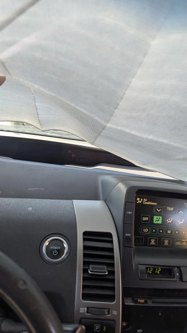

Why won't my dash lights come on and the car won't turn off… Anyone else had this problem?
I was driving and suddenly the dash lights just went out. Tried turning the car off and back on, but nothing changed. The screen stays on even when I try to shut the car off and open the doors.
It’s a 2008 Prius with a brand new 12v battery. I didn’t hit any buttons or anything, it just happened on its own. Anyone know what’s going on?
Try holding down the power button to force the car off. If that doesn’t work, head to the back and disconnect the 12v battery to reset it. You just need to pull out the thick white plug near the positive terminal for about 5–10 seconds, then plug it back in. No tools needed.
Sounds like you’re dealing with the combination meter issue.

Yeah, that’s a common Gen 2 Prius issue. Holding the power button down for a while should shut it off. I usually disconnect the 12v battery for a bit afterward just to be safe. The combo meter probably needs to be repaired or replaced to fix it long term.

Your combination meter has bad capacitors, and that’s why it’s acting up. It might be on and off for a while, but it needs fixing. You can DIY it using YouTube tutorials, or get a refurbished meter from Texas Hybrids with your VIN and mileage programmed.
