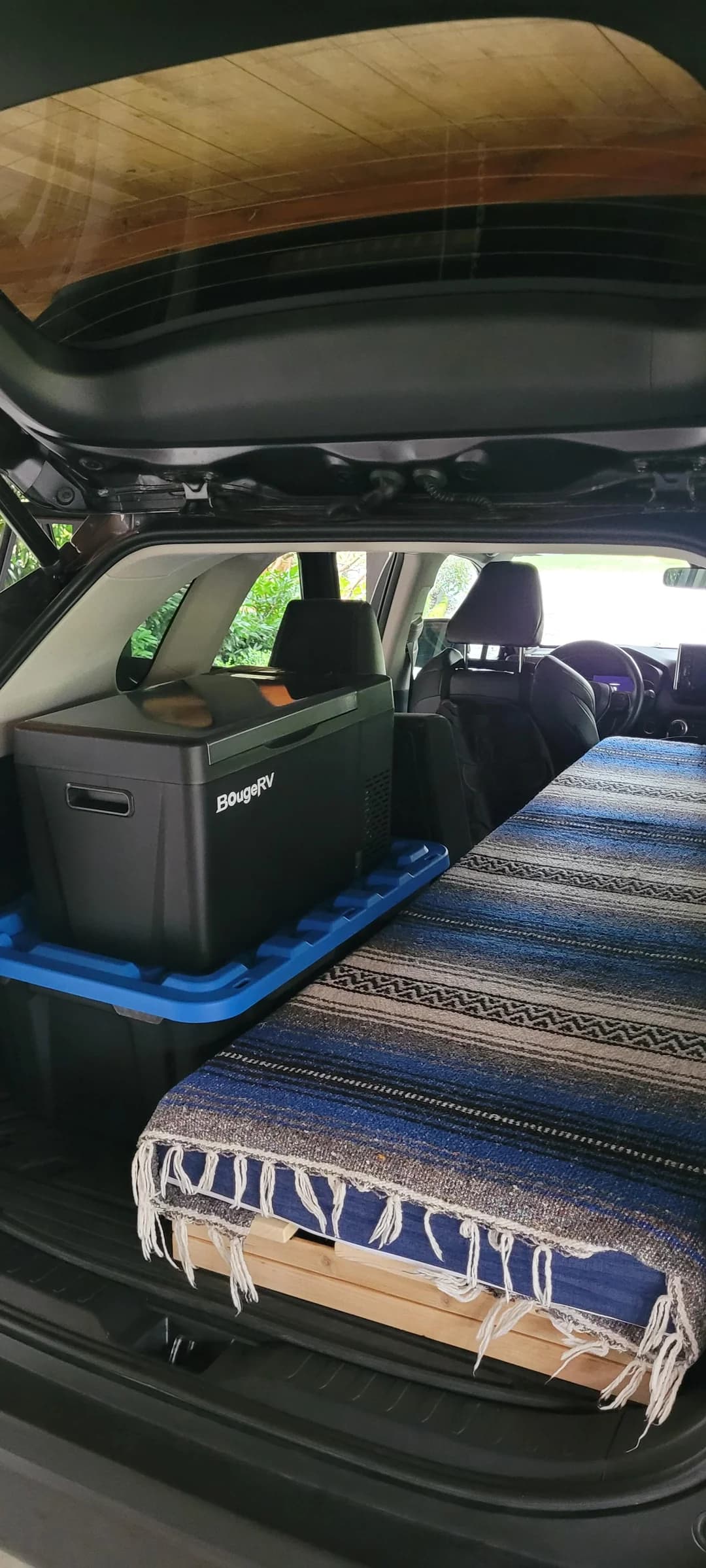

Any way to leave the hatch open without killing the battery?
Trying to finish up my car camping setup and ran into a problem. I left the hatch open for a while and ended up with a dead battery. Had to use my jump pack to get it going again. I’d like to be able to leave it open for things like cooking or chilling at the back without worrying. It’s one of those auto lift hatches. I’ve seen people say it can’t be done or needs a bunch of steps every time. Anyone got a simple trick that works?

This is how you stop the car from acting up when the hatch is open. Just grab a flathead screwdriver and push the latch inside the hatch to make the car think it’s closed. Then all the lights shut off. To reset it, hit the button on your fob or inside the car. Works every time.
@JeffPatterson
Used to do this with my old Toyota wagon. Just click the latch shut and you’re good. Hours at the track like that and never killed the battery.
