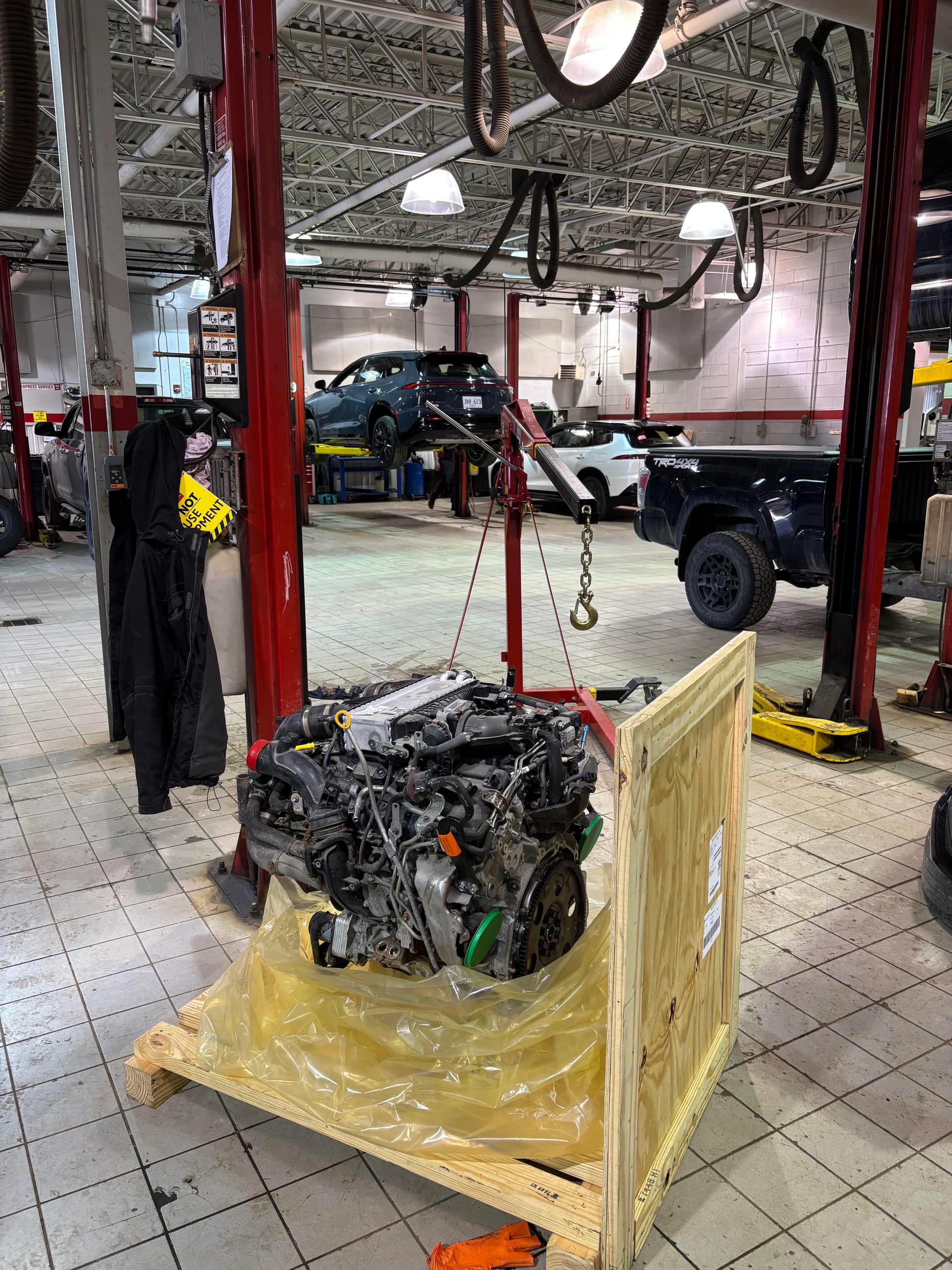

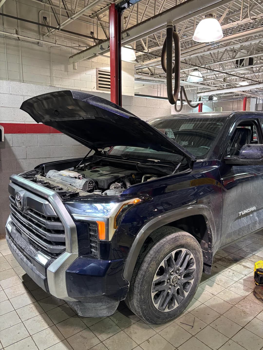

This past Monday was our first engine replacement in the dealer as part of the Campaign RG0 here in Canada! Although I was a little nervous, it went pretty smoothly and no issues once complete!
Another one starts next Monday!

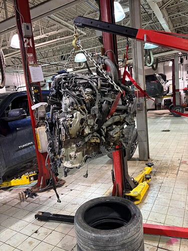

Is that even an engine in the third pic, or just a pile of random wires and hoses dangling from the hoist?
Haha! That’s the old engine with the harness still attached. At this stage, we lower it down, remove the harness, and transfer it to the new engine. Next time, I’ll try to get more step-by-step pics to show the full process.

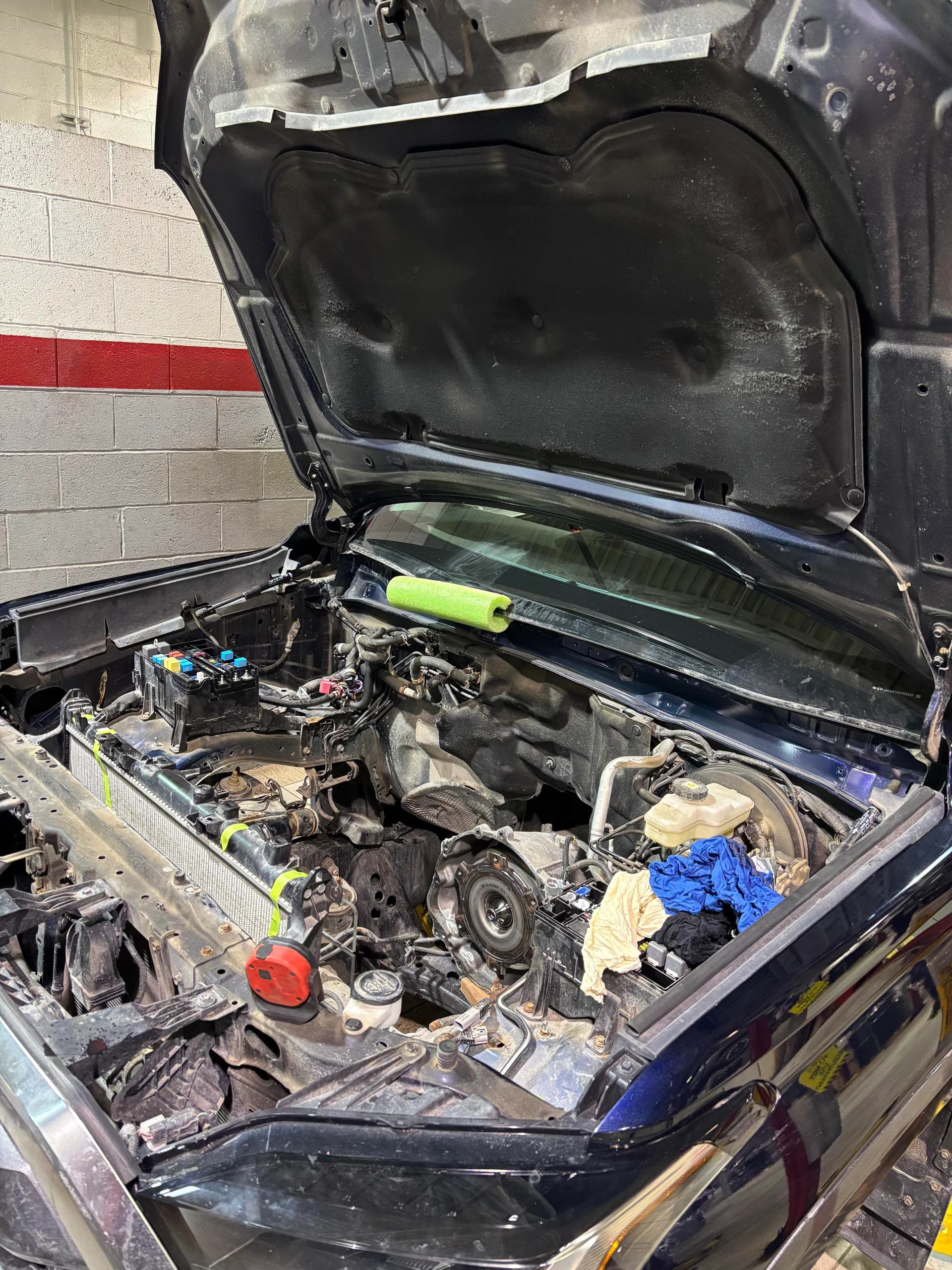

Thanks for sharing this! Cool to get some insight from someone actually doing the work. Crazy that you can swap it with the radiator and hood still on.
Toyota gave every dealer a special cherry picker for this so they could pull the engine without removing the front end. Before the recall, if you had to replace one, you’d have to pull the whole front end off, and some shops were even lifting the cab.
