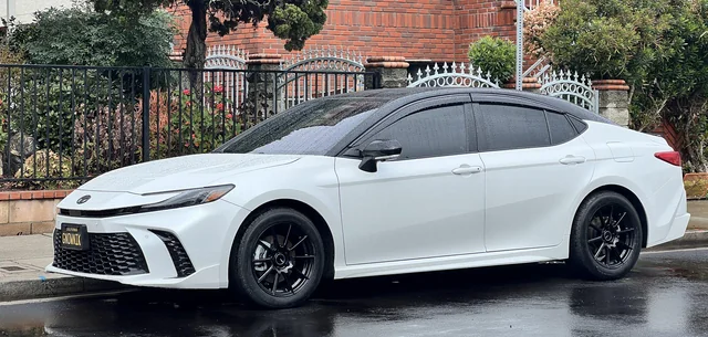

I’ve had this car since July last year and love almost everything about it. But I’ve had mixed feelings about the stock 19-inch wheels. They’re smooth on most roads, but on rougher ones, the ride can get uncomfortable.
I swapped them for 17-inch Enkei TS-10 wheels, and the difference is noticeable. The ride is much more comfortable without feeling too soft, probably because of the XSE’s suspension. I’m running 32 psi (the tire pressure calculator suggested 31 psi) instead of the stock 35 psi. I also kept the stock 235 width tires, so handling hasn’t changed much.
At first, I was worried the smaller wheels would look off, but I think they turned out fine.
Specs: 17x8 +45 offset, 235/50R17 tires.
Not sure why photos didn’t show up at first, but here it is lol

It actually looks pretty good. I like the chunkier tire look.
Thanks! I’ve always liked the beefier tire look too.
