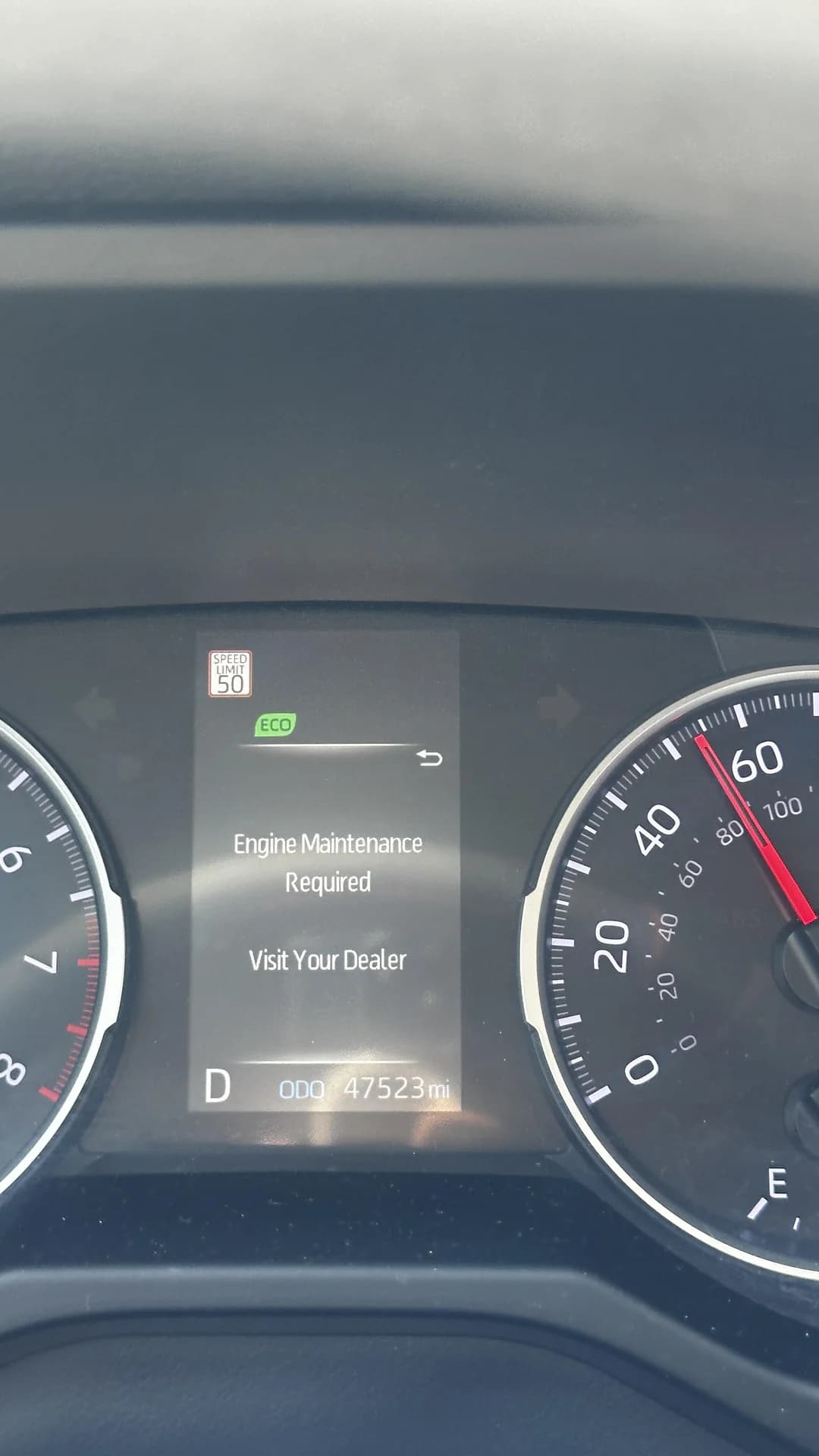

This message won’t stop showing up on my mom’s RAV4… any ideas?
This message has been popping up for a few months on my mom’s RAV4. It’s driving me nuts. None of the warning lights are on. I already reset the maintenance reminder when I did the oil change, but the message still comes back every time. Any help would be great.
You probably need to replace the coolant bypass valve.
Yep, been through it myself. You don’t have to use the dealer unless it’s still under warranty. Mine tried to charge $900, but I bought the part and had a Toyota shop do it for under $300.

What should I watch out for if it’s the coolant bypass valve? I keep seeing the message too, but I figured it was just the reminder for tire rotation or oil change.

Mine did this at 52k. I’ve got an extended warranty, so I paid $100. The repair invoice was $1100 mostly for labor.

Yeah it’s just a long hose with a bunch of fittings. It’s tucked behind the engine so a pain to get to.

How do you know for sure that’s the issue?

I’m a service manager at a Toyota shop. Every time we see this message without a check engine light, it’s always the bypass valve.

It’s a known issue. Tons of us RAV4 owners have had it. I replaced mine a few months ago.

I had it done under my extended warranty and didn’t pay anything.
Coolant bypass valve. I had the same issue.
